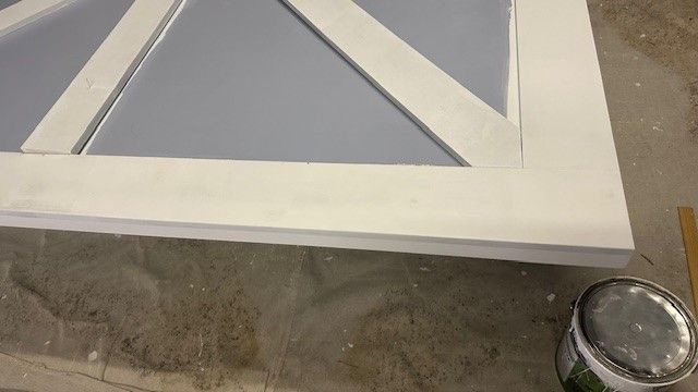

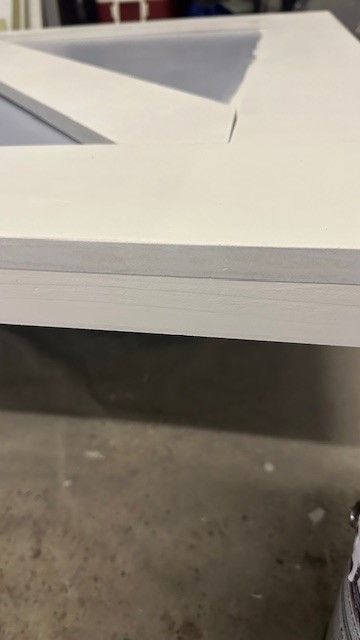

I have modified the doors i purchased and made them more into a barn door style. In regards to the hinges suggested i need to resolve this last problem.
I added 18mm depth timber to the doors to create a barn door style.
The width of the door is 35mm and the width of the timber added is 18mm see picture. I would like to get hinges that extend beyond the 18mm (added timber area) so i am screwing in the hinge into the 35mm of the original door. Can you point me to hinges that extrude beyond the 18mm.barn door for hinges.jpgbarn door for hinges 1.jpg
Re: 2 x external solid doors which are very heavy
Hi @Miczam,
You'd likely need to go with a wide throw hinge such as the Pinnacle 100mm Satin Stainless Steel Wide Throw Hinge Single.

If the width is 100mm and depth 125mm then the depth of my door is 50mm, how will i be able to fix the hinge to the edge of the doors?
please advise
It's quite hard to visualise with placing the hinge up against the door @Miczam.
Perhaps the below diagram might assist. As you are creating a custom-door, you'll need to test fit to see if it works for you.

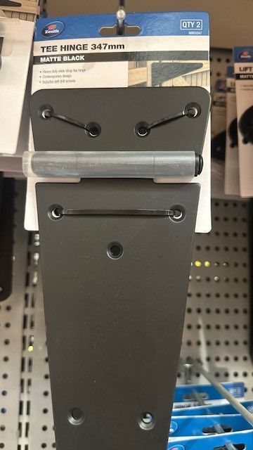

As you are aware i am making 2 barn doors for external use and they are very heavy around 55kilos each. So you have recommended i use the heavy 100mm wide hinge heavy duty hinge. They only come in silver. I have purchased these,. However when i was in Bunnings yesterday i saw these T Hinges black (see below picture of it), they say they are heavy duty. Would these hinges be suitable to handle the heave door i have have.  Door size 1200mm x 2040 x 35mm x 2 doors.black t hinge (Heavy duty).jpg
Re: How to hang external solid doors?
Hi @Miczam,
You could certainly try them. As per the previous recommendations, you'll need to use at least three or more per door. What those hinges don't have is ball bearings, which are commonly used for doors of your size. Ball bearings allow the door to be easily opened and extend the life of the hinge.
