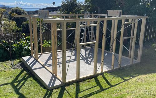

3/9Build and erect framing

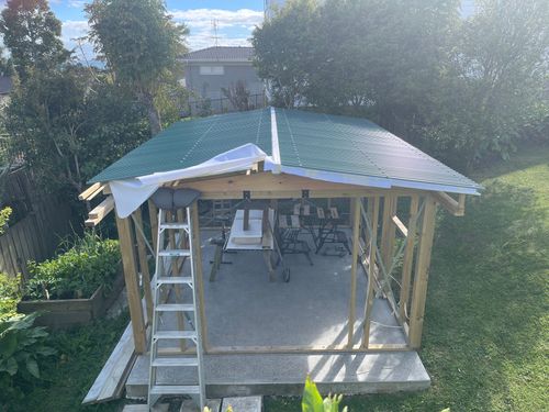

4/9Install beams, ceiling panels, purlins, insulation, building paper and colorsteel roofing…

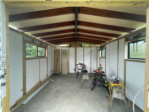

7/9Instal insulation, line walls with gib and stop gaps.,.

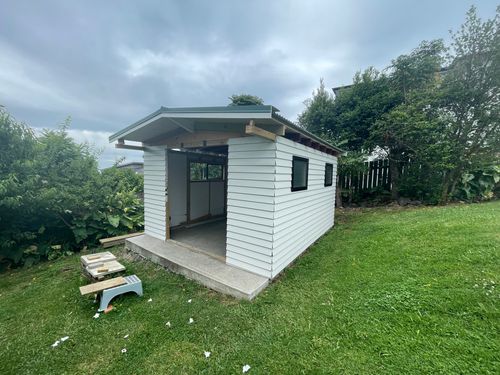

The design is simple but clean and extremely well done. The white weatherboard cladding looks fantastic with the green roof and the black aluminium windows and door giving a pop of colour.
I'm intrigued by the triangular window at the back of the workshop. What is the idea behind this? Was it simply to get as much natural light in as possible? Or was there a specific utility for this window?

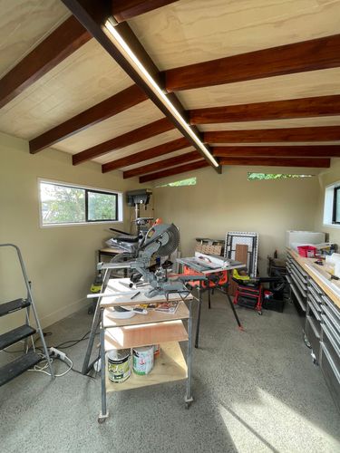

The exposed rafters look fantastic and are truly the highlight of the structure, but I have to say my favourite part of this project is the handshake photo after a job well done.

Hi Jacob, thanks for the kind words. ‘Glad you like the shed… The windows and ranchslider came from a demolition yard - good recycling… A friend named Leigh visited when only the framing was up and she suggested leaving the triangular spaces as windows on the east wall. They took a bit of work to frame, ‘well worth it though as they now let more sunlight through in the morning. We call them the ‘Leigh lights’ - so thanks Leigh!:)

Geoff, you and your son are inspirational! It's a gracious structure which you have built and helps to change the 'shed' concept from purely functional.
I was also taken with your concept drawings. A question....the roof is being held together without collar ties or ceiling joists so what has been used at each end of gable roof to give it lateral stability? Once again 'well done'.
FrantzJosef
Re: A workshop for Max and his dad
Hi FrantzJosef, thanks for the kind words and for the questiion re lateral stability… look closely at the photos… there are metal brackets joining each beam to the ridge beam and the frame along with assemblies at each end of the ridge beam to also attach it to the frame. The gable height is low and the ridge beam takes the lateral force. I’m not an engineer but that is how I see it. I decided the ridge beam and beam approach to the roof meant no need for trusses and provides an attractive and higher ceiling space. I had an engineer visit our home for another project. He looked over our work on the shed and was ok with it.
