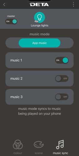

The model is  DET902P4HA.
I thought I had seen somewhere in the box/instructions that the feature was included but going back to look maybe it’s not. I just assumed that as the app detects the specific lights that it would only show me options to select features that are actually available?

Hi @kh17,
I've spoken with the technical team at Arlec (Deta's parent company) who have told me that music mode will only work with music that has been downloaded to your phone, not streamed music through apps like Spotify or Apple Music.
You can download music through these apps so they can be accessed without an internet connection. Try doing this and see what results you get.
If this is not successful, it is likely worth giving their technical team a call on 1300 267 168 in Australia and 0800 003 329 in New Zealand so they can talk you through the troubleshooting process as you do it.
Let me know if you have any further questions or require further assistance.
