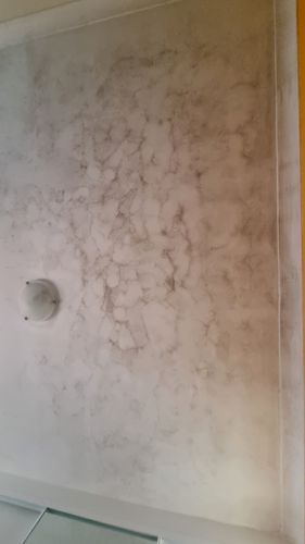

I have tried to fix the mold in the ceiling of my bedroom using the natural green goo. No improvements. The leaking pipes have been fixed but I still cannot get rid of the mold. Any suggestion? Thank you!

That's a natural product that should be effective at killing mould spores. It contains clove oil, which is one of my favourite items to kill mould with. However, it doesn't appear to be a cleaning agent, so it won't necessarily remove the staining on the ceiling. Since you've now killed the mould and resolved the leak, you can paint the ceiling. I've done plenty of mould cleaning in my time and I can tell you it will be far easier to paint that ceiling than try to remove the staining.
I recommend adding Protite 75ml Mould Defender Paint Additive to your ceiling paint to prevent mould from returning.
Here's a helpful guide: How to paint a ceiling.
