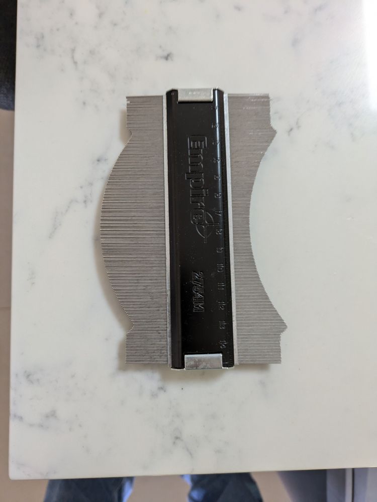

I have a needle file(?) that can take the shape of the cornice. Will this help?
