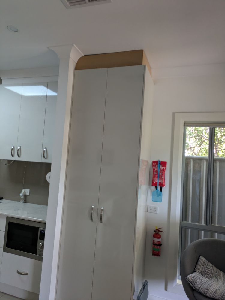

I have had a pantry installed in my kitchen and as you can see from the photo, the job requires 90mm cove cornice installed around the bulkhead.
I do not want to cut into the existing cornice, but but into it with what I think is called  a scribe joint. I watched a video on how to cut  a scribe but I just cant picture how this works with a cornice.

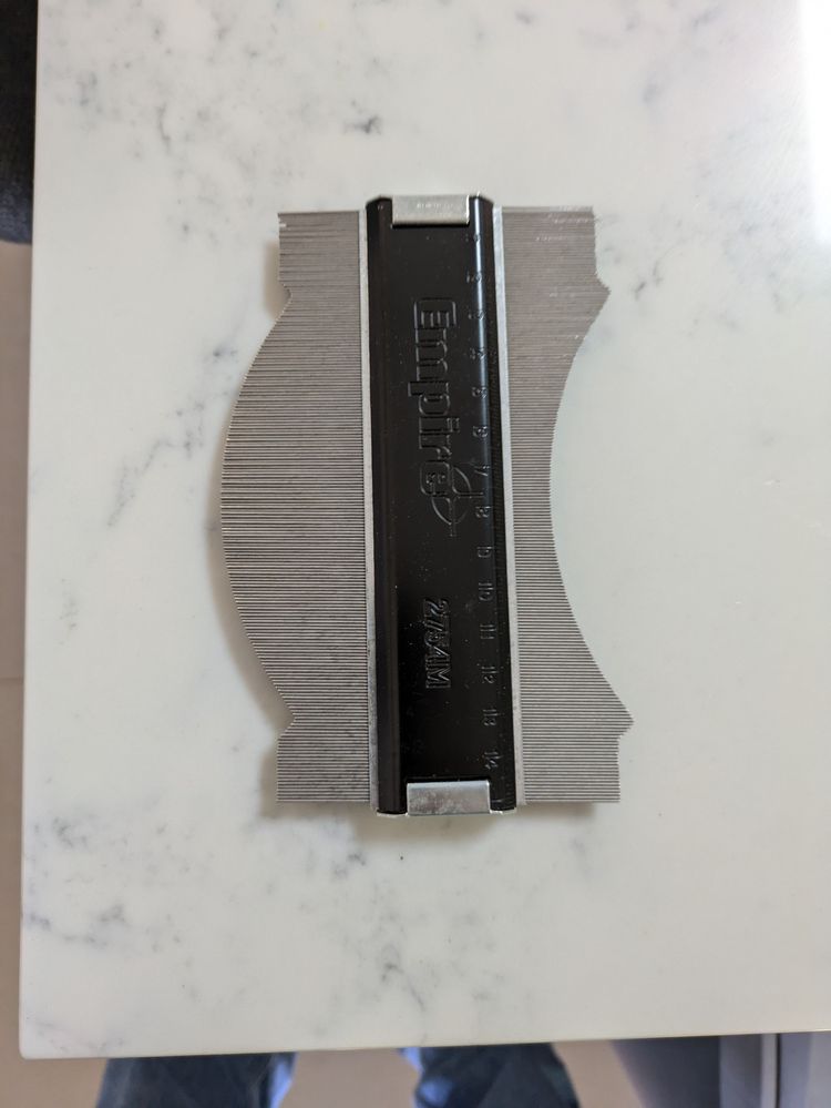

I have a needle file(?) that can take the shape of the cornice. Will this help?

Nooo The piece you have in your hand, bring it towards you so it can sit over the short piece fo cornice on the wall, then you draw the arc on the back of the cornice.

I understand where your coming from now. I take it I need to trace the right hand side of the pillar from behind not the left hand side to get the right angle?

The 90mm mitre box can make the cut, but in your case you're butting against the other cornice - so you have to visualize straight on and cut the beveled edge away at 90 degrees with something like a coping saw.

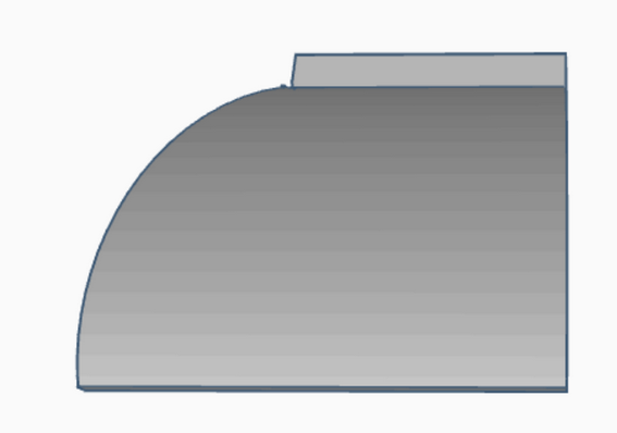

Great minds, hey! I've been drawing it up. As best I can tell, even though it's a butt joint and not a mitre, it's still a standard mitre, but with the top edge flattened off.
