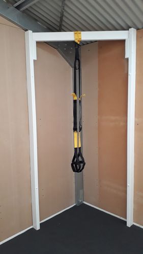

@JustinMcAbbe.... Just an extra thought....  are you able to put the bag near a corner?
A corner is a stronger part of the structure (but necessarily of the ceiling) and the moving/swaying forces will be transferred to that stronger area.  If so, you could put some padding on the walls to catch the bag as it swings, which will also limit its swaying action on the beam and ceiling.  It would also mean you can a shorter support beam and still get support from the 2 walls.
I have included a photo of what I made to support a "T-Rex style" exercise unit in the corner of a metal shed. No ceiling, but then the unit doesn't weigh much and the forces on it are much gentler than would be for a punching bag. My upright timbers go to the floor due to the fact that the working forces are pulling it away from the wall and also being no ceiling support. (There are corresponding uprights placed behind the wall lining too, bolted to the shed frame when I lined it, so nothing is going anywhere it shouldn't.)
I hope it isn't sideways???I hope it isn't sideways???
