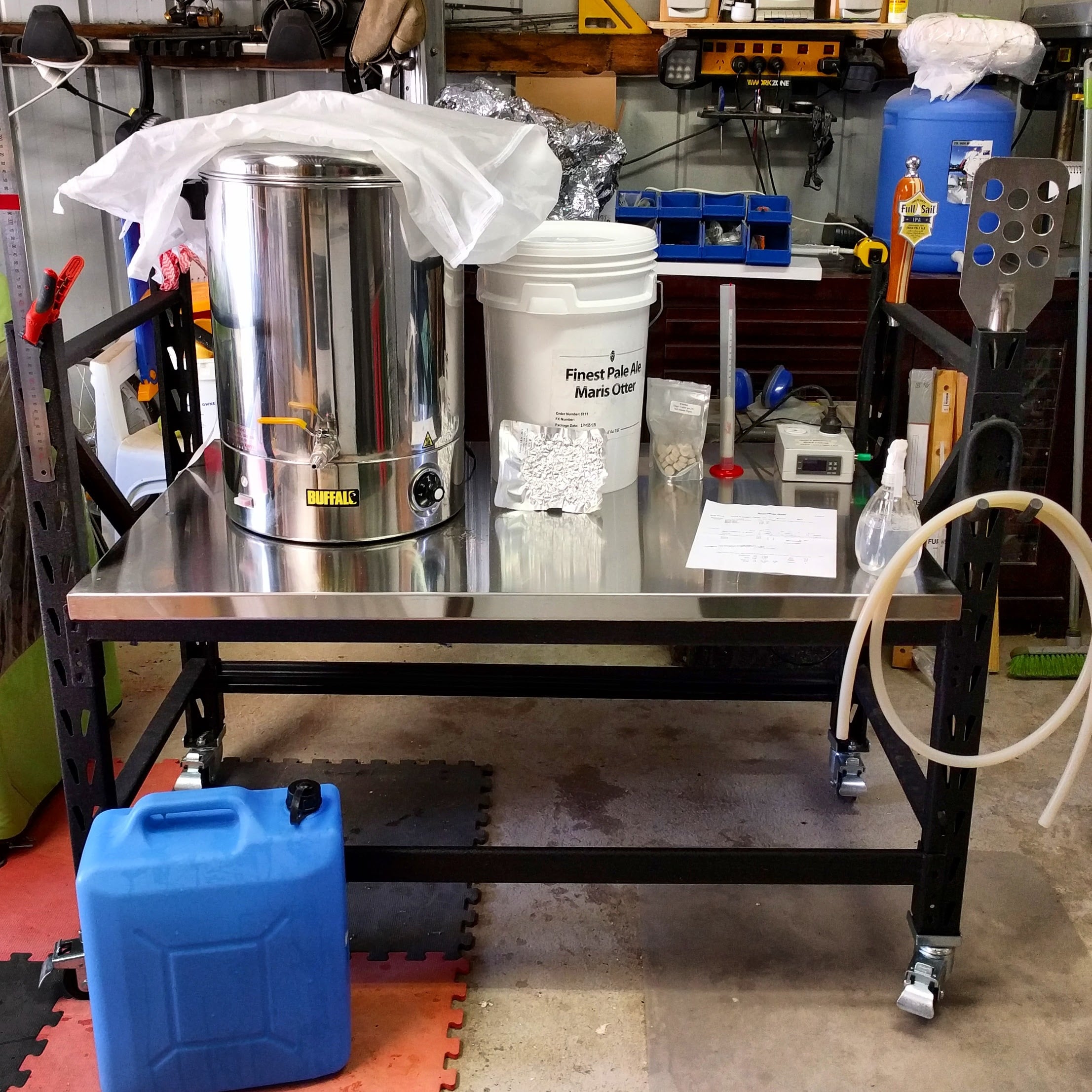

I've been a home brewer ever since I got a Coopers DIY Beer Kit for my 21st birthday, but only in the last few years have I moved to making the stuff from scratch. I'm talking crushed grain, hops, the whole shebang.
DISCLAIMER 1: This is the process that *I* use to make beer, by no means is it the only way to do it.
DISCLAIMER 2: I've only been doing this for about 18 month, and couple that with a young family, this is only my 7th batch, so I've still got a lot to learn.
In this post I'm going to run through how a typical brew-day for me works, and maybe hint at the processes down the track.
The technique I use is BIAB (Brew in a Bag), and is a simplified version of the traditional 3 Vessel system that only requires a single vessel and heat source. BIAB systems can be purchased ready to go (ie GrainFather, RoboBrew) or, as is typical for homebrewing, you can DIY up your own system, which is the way I went.
So, lets get started, shall we.
I'll break this into a number of posts to make it easier to read (and write too).
Mick0s
PART 1
PREPERATION:
- Find a recipe, today I'm making a Stone & Wood Pacific Ale clone. There's lost of software that can assist in fine tuning a recipe you might find, and these can also print out brew day steps with all the info you need.
- Clean everything, and then clean everything again. A stray infection can ruin a brew, so make sure everything is as sanitary as possible.
- Mill your grain bill - or you can buy it pre milled, but I got myself a birthday present this year, and can now mill my own.
This picture shows the grain pre and post milling. as well as my mill setup.
