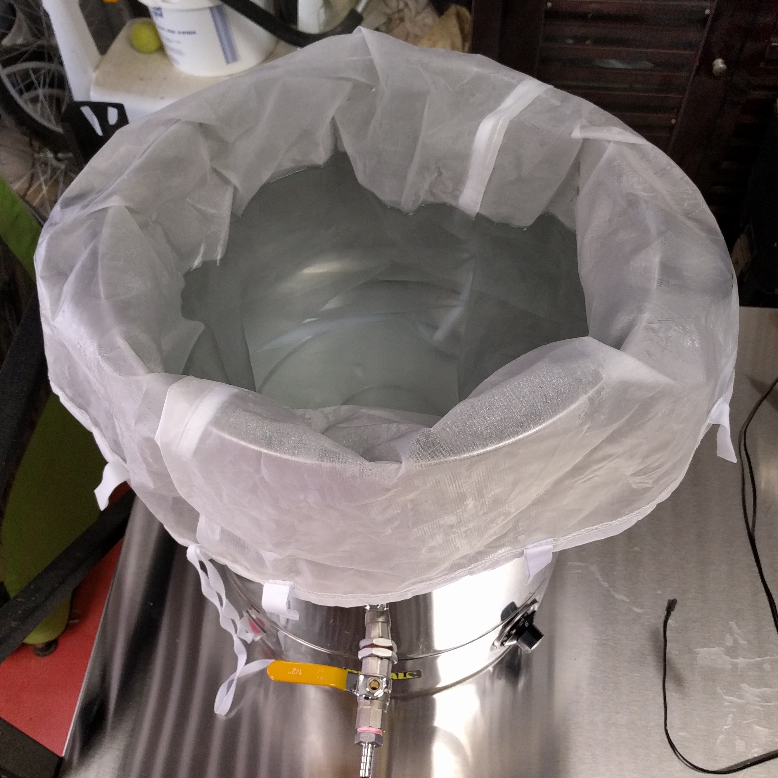

The technique I use is BIAB (Brew in a Bag), and is a simplified version of the traditional 3 Vessel system that only requires a single vessel and heat source. BIAB systems can be purchased ready to go (ie GrainFather, RoboBrew) or, as is typical for homebrewing, you can DIY up your own system, which is the way I went.

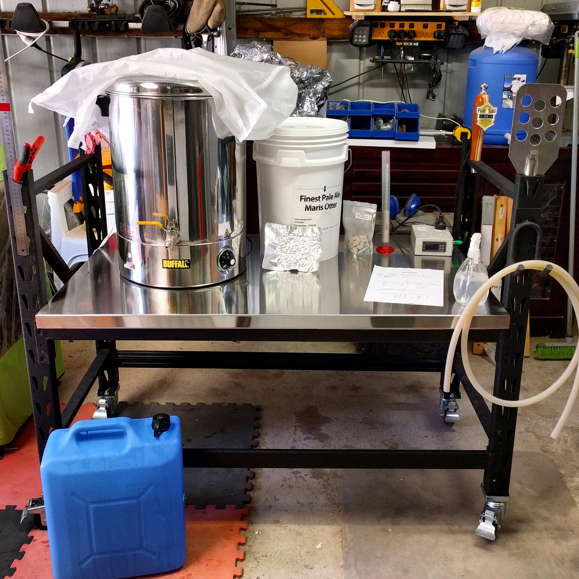

- Find a recipe, today I'm making a Stone & Wood Pacific Ale clone. There's lost of software that can assist in fine tuning a recipe you might find, and these can also print out brew day steps with all the info you need.
- Clean everything, and then clean everything again. A stray infection can ruin a brew, so make sure everything is as sanitary as possible.

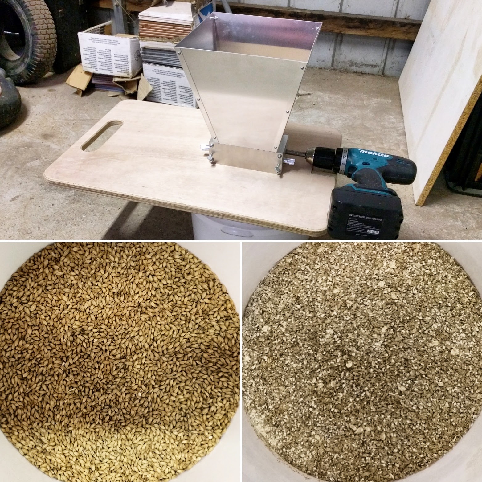

- Mill your grain bill - or you can buy it pre milled, but I got myself a birthday present this year, and can now mill my own.
This picture shows the grain pre and post milling. as well as my mill setup.

When the temperature is reached, we can add the grain bag, and the milled grain, giving it a stir with the mash paddle to break up any lumps.

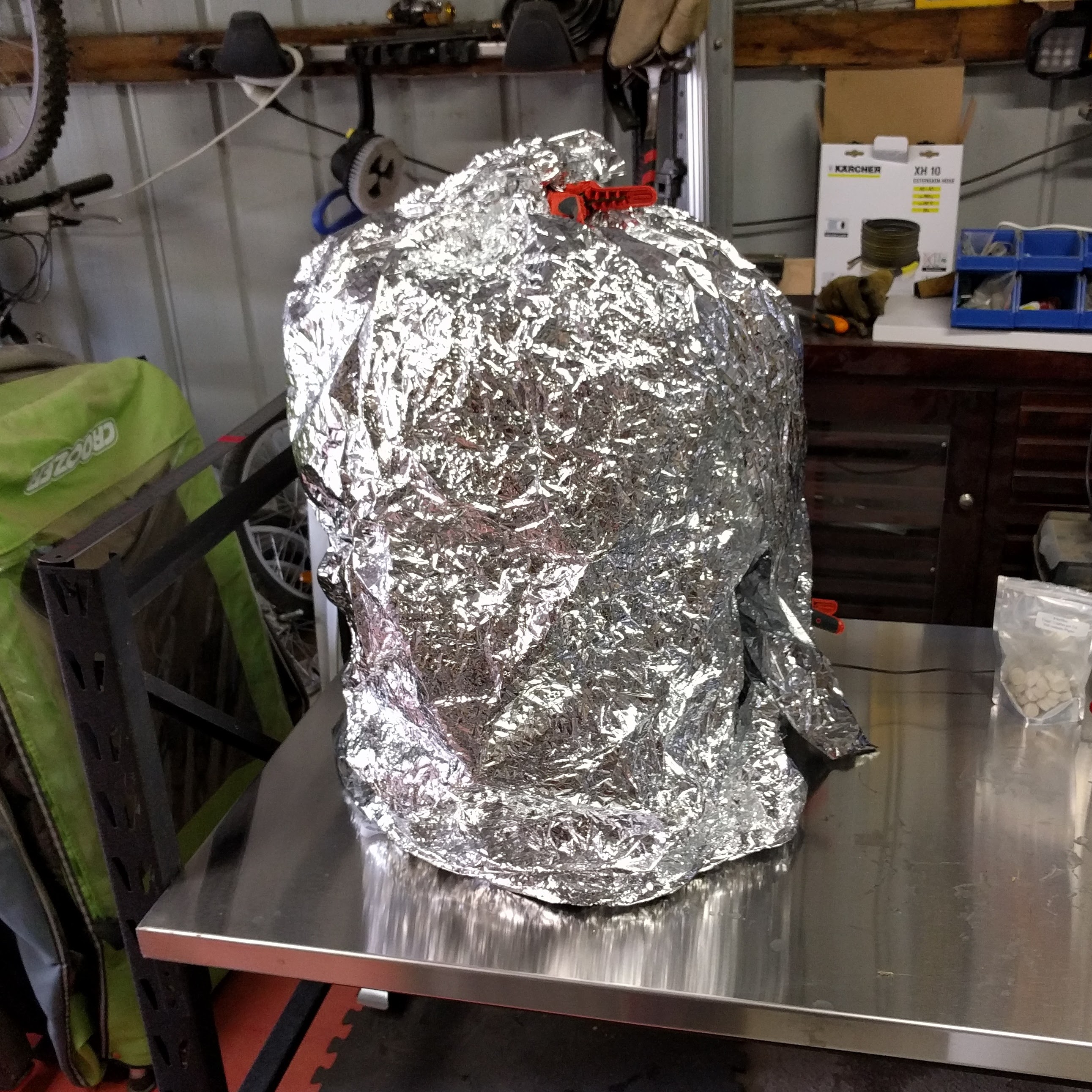

At this point we turn the heat off, and wrap it all up in a nice emergency blanket, and leave it for about an hour or so.

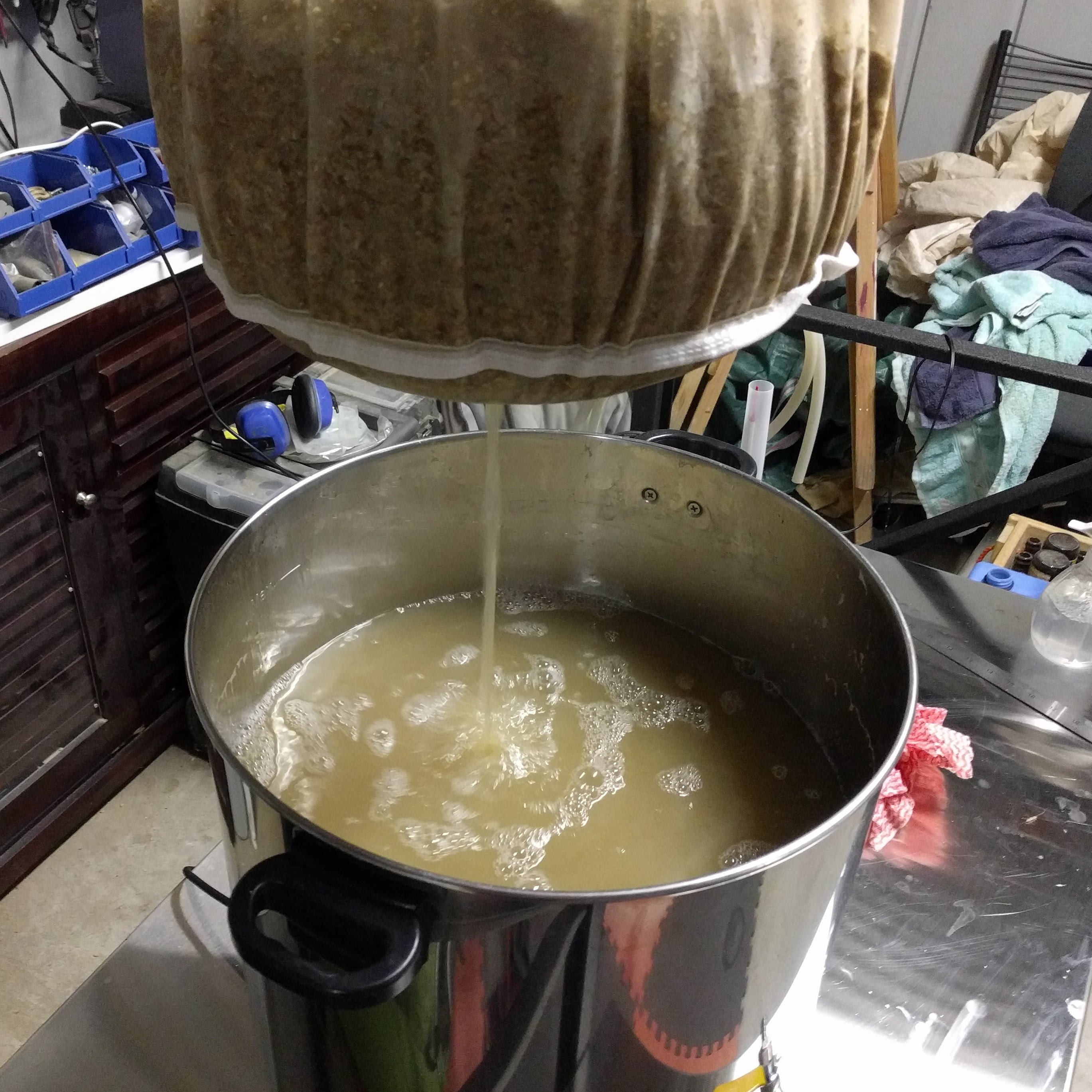

Once that's done, we can hoist the bag out, removing the spent grain from the urn, and leaving the hot liquor behind, ready for boiling. Not forgetting to give the bag a squeeze to get all that sugary goodness out.

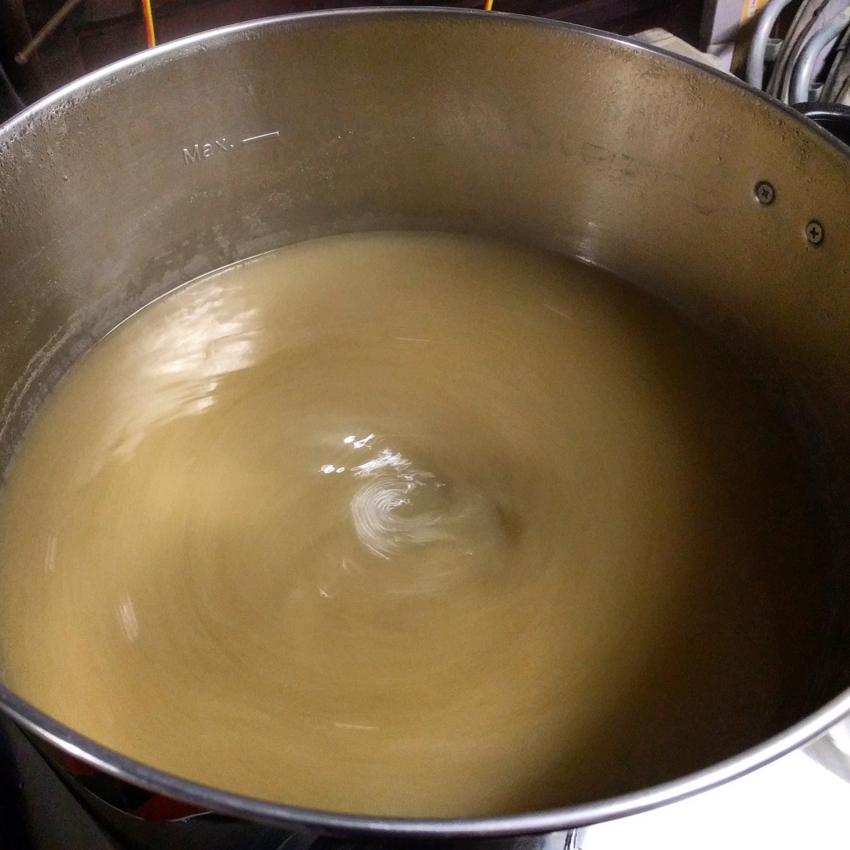

Once the buzzer hits the 60 minute mark, the urn get flicked off, and I'll stir the urn into a whirlpool, put the lid back on, and leave it for about 15 minutes.
Together with the Whirfloc tablet, this helps to coagulate all the crap (trub) in the urn, and bring it all to the center, so that we can leave it behind in the urn when we drain the rest of the wort off.

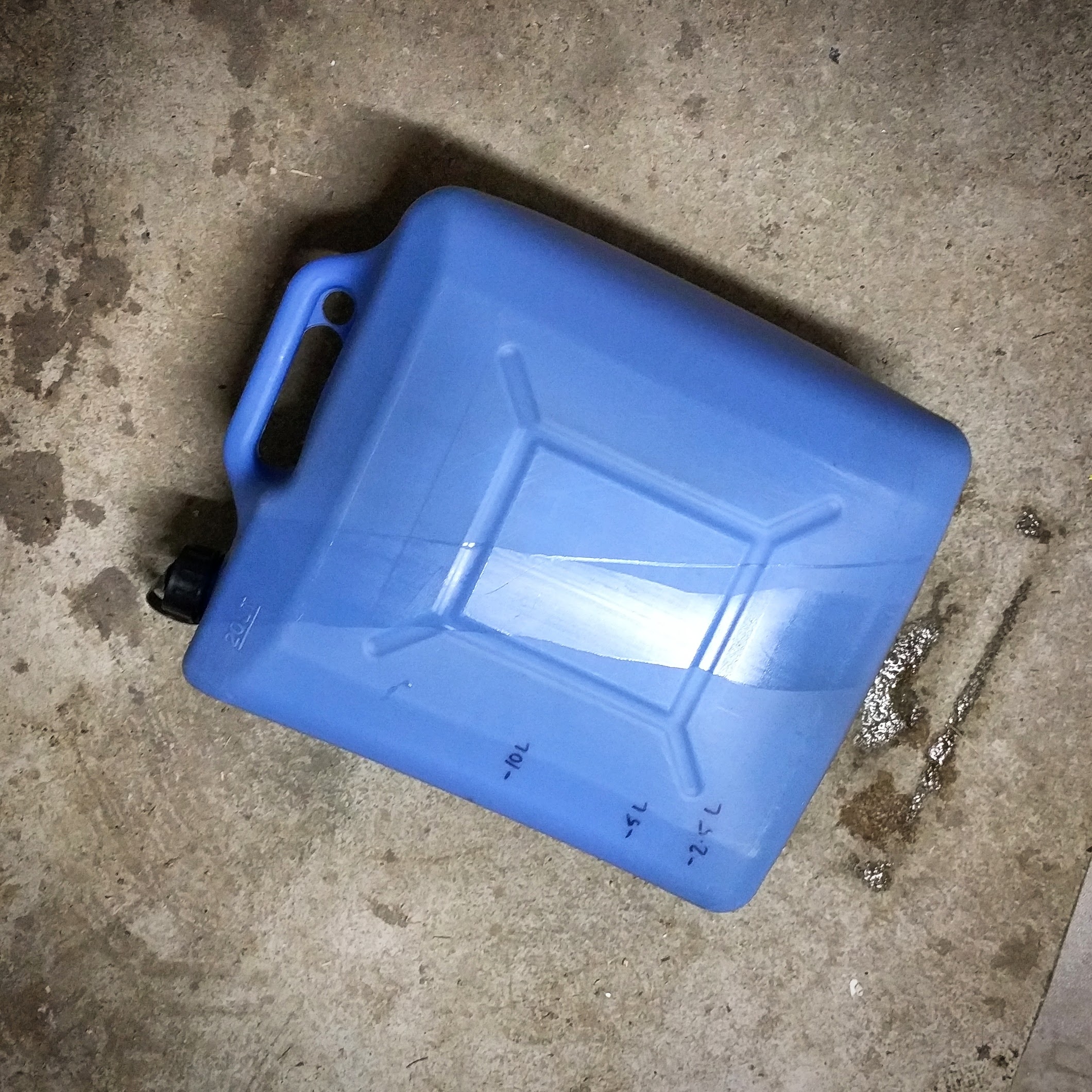

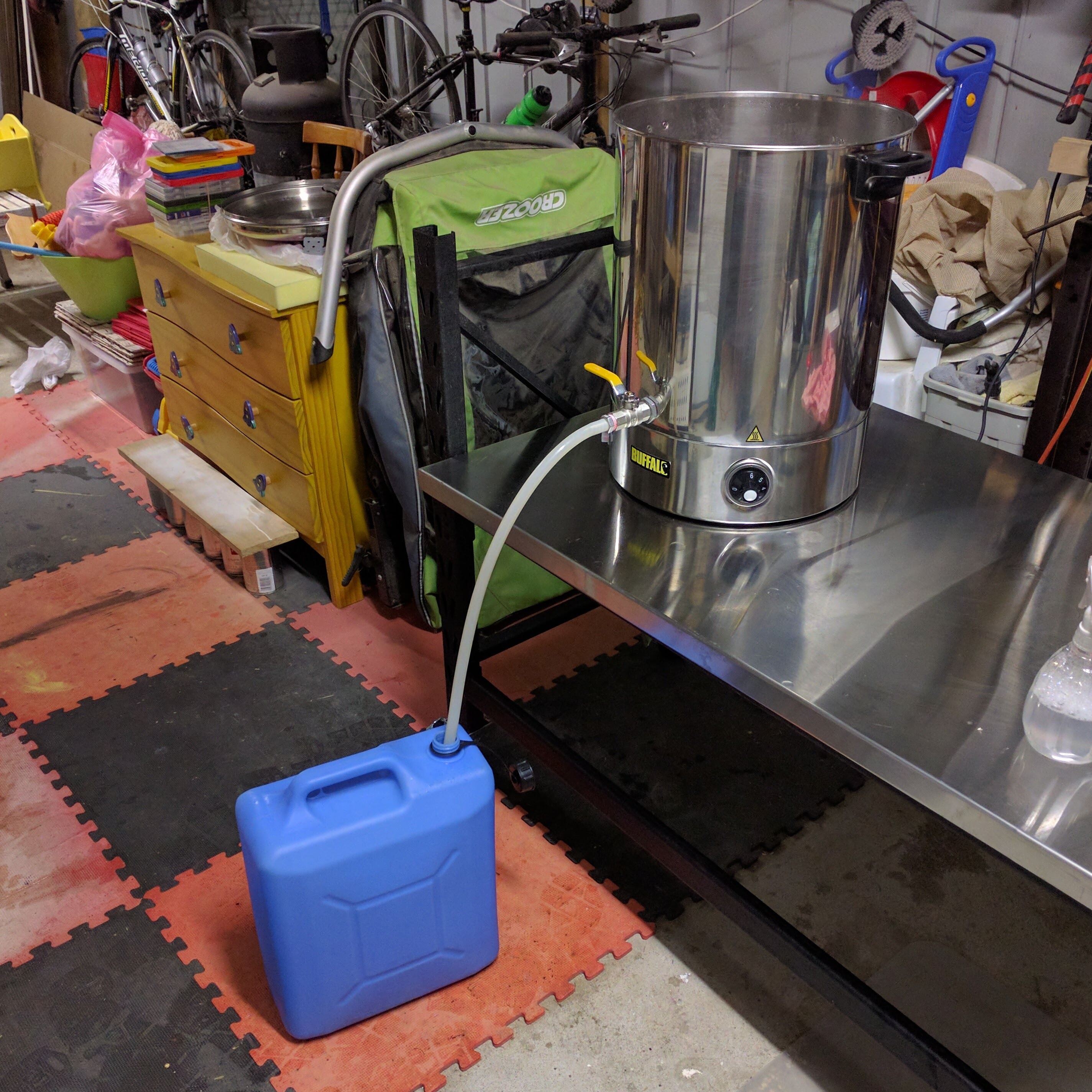

This point is where, typically, you'd use some sort of immersion chiller to bring the wort down to about ~20 degrees and pop in into the fermenter with some yeast and let it do its thing, but I use a different process here, called no-chill.
In order to no-chill, we'll transfer the still hot wort to a 20L 'cube' or plastic jerry can, making sure to fill it as close to the brim as possible. Once full, any remaining air is squeezed out, and the cap put on. We can just leave this so cool down naturally. This process means that, because the wort is still near boiling, you have to adjust your hop times slightly accordingly.
There are mixed opinions the no-chill process, but I find it handy, as I can brew one day, and then call it a day, without having to worry about cooling and fermenting for a few days.

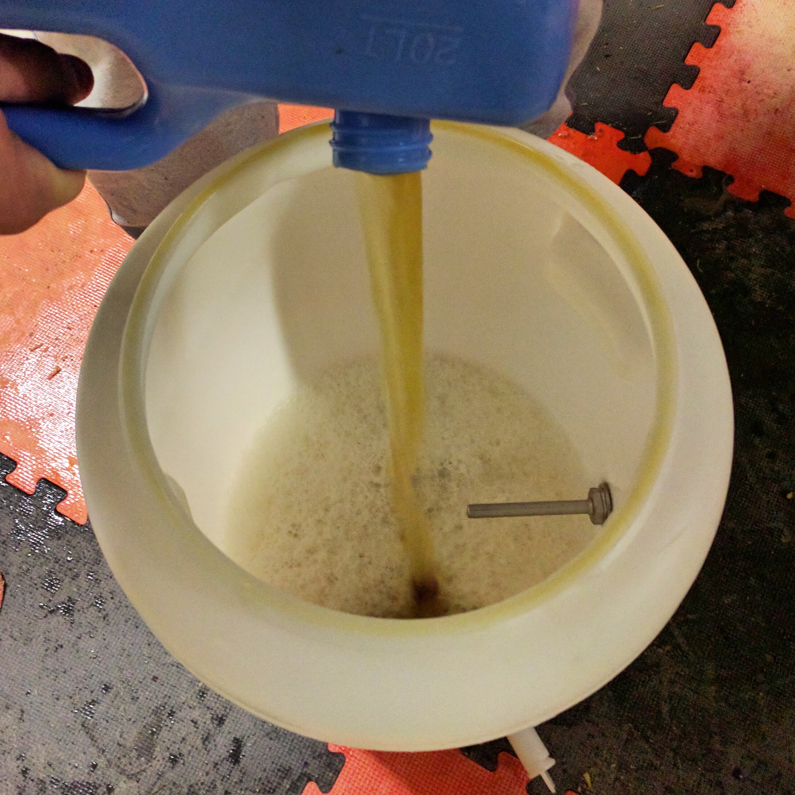

Now that our wort is cooled down, its time to move it all to the fermenter.
Open the cap, spill a little bit all over the place, and dump it all into the fermentation vessel. Splashing is good here, as the yeast will like the oxygen mixed in.
Splashing after this point is bad, as it promotes oxidation, which can cause a stale bread, wet cardboard type flavour.

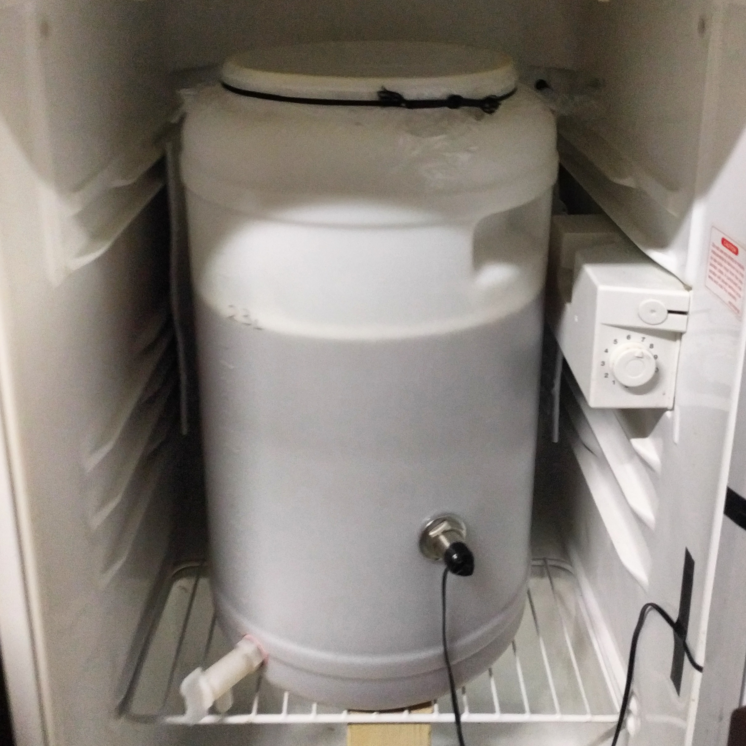

Once the foamy head has let off a bit, we pitch in the yeast, strap on some cling-wrap (I find this easier, and just as effective as a lid with an airlock, and less to sanitise) and pop it into the temperature controlled fridge.
Here, a temperature probe is fed into a thermowell on the tub, allowing the temperature controller to manage the temperature of the wort to keep it around the 18C mark (by alternatively turning on the fridge, or the head pad attached to the inside of the door).

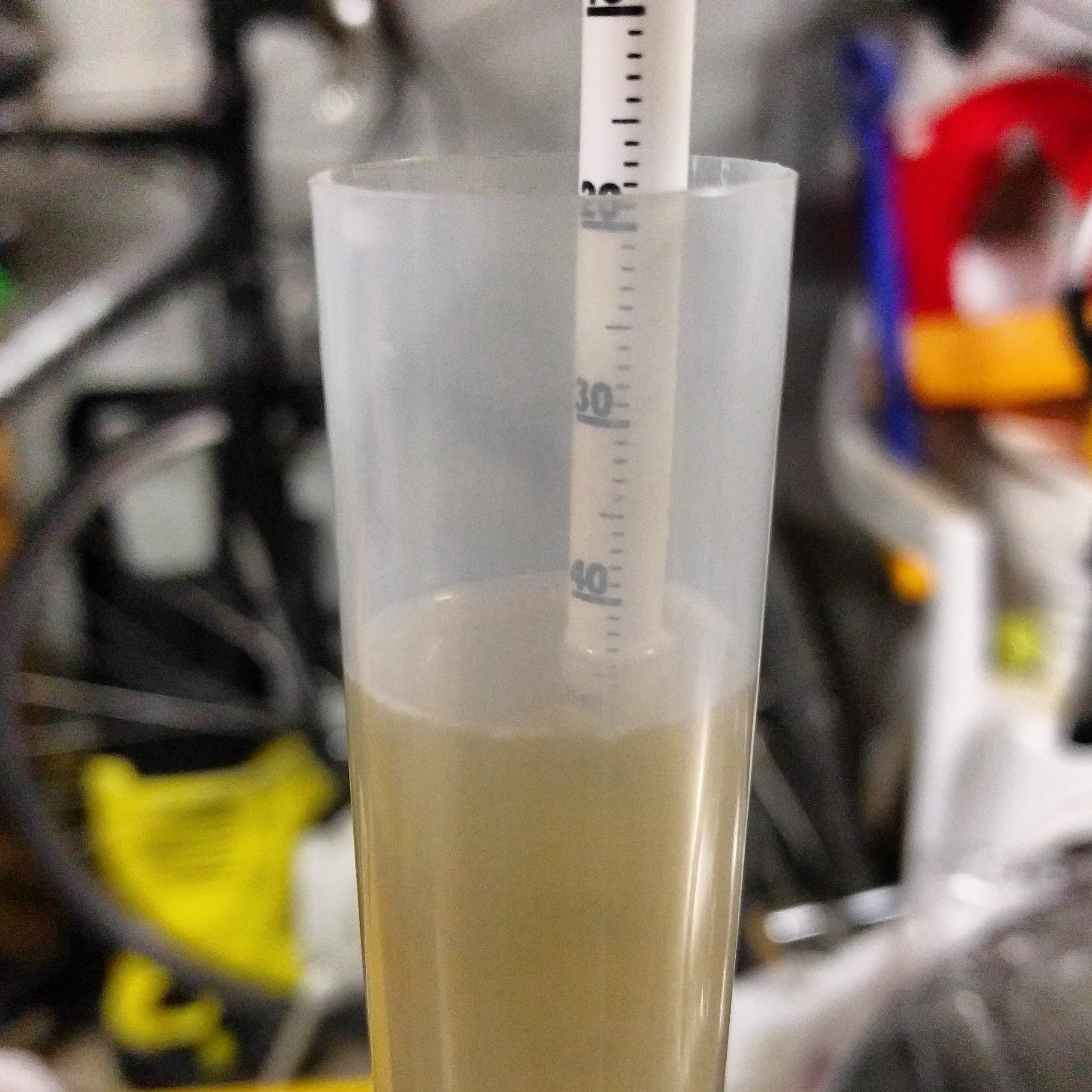

Oh, and don't forget to take a gravity reading, so you can tell when fermentation has stopped (and get a rough alcohol % too).
Here I've hit the expected 1.043, meaning that its heavier than water (water being 1.000) due to the dissolved sugars. As these sugars ferment and turn into alcohol, this reading will get closer to 1, and probably level out at around 1.005 or a tad higher. And online calculators will tell us that should be an alcohol content of around 5%.

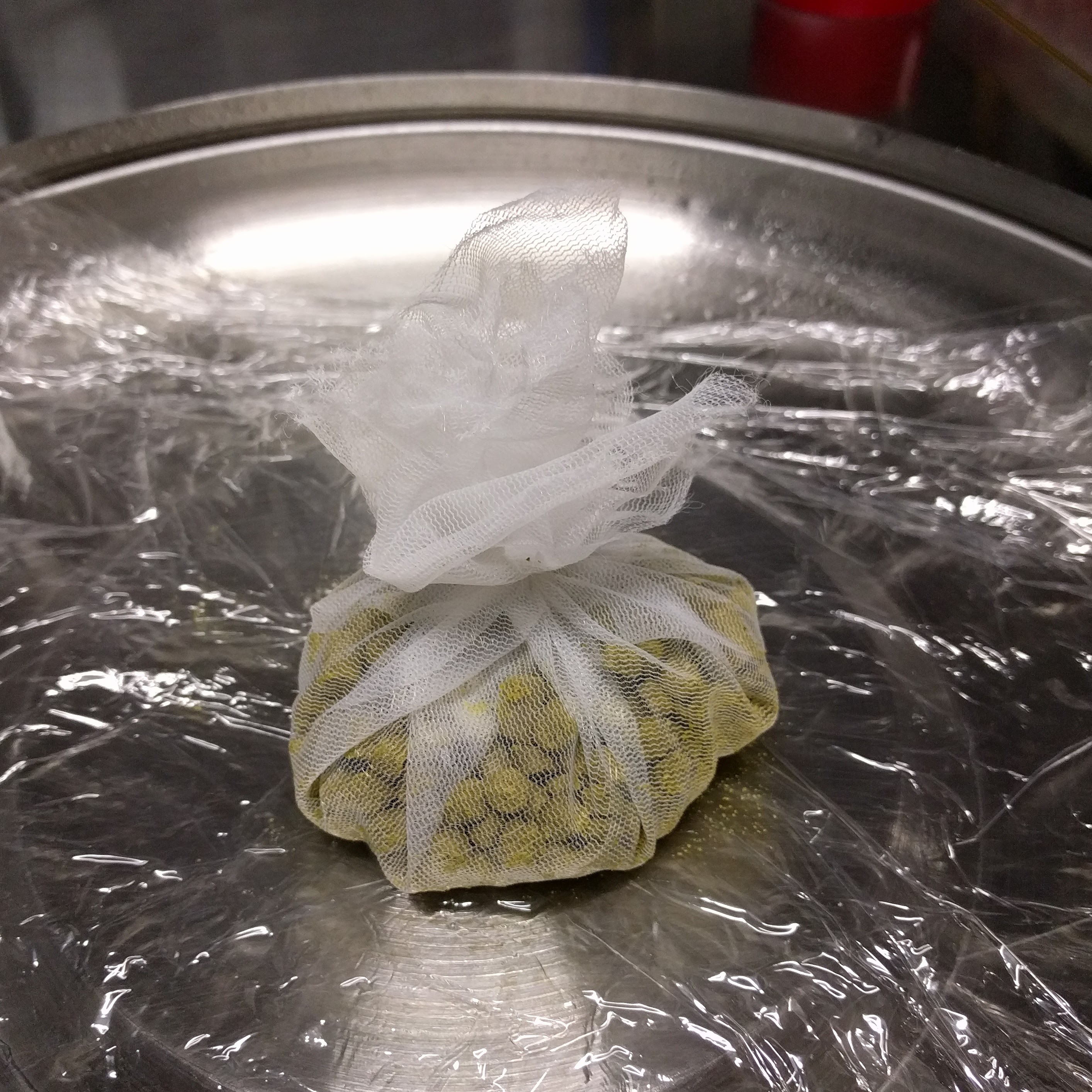

STEP 5 : DRY HOPPING
One thing that this recipe calls for is dry hop additions, so after almost a week into fermentation, I pop the remainder of the hop bill straight into the fermenter wrapped up in a sanitised paint strainer bag (this will be mainly for a burst of aroma), and change over the cling-wrap top for a clean one.
A quick gravity measurement at this stage shows that it's doing its job, as the reading shows 1.010 now. And back into the fridge it goes.
