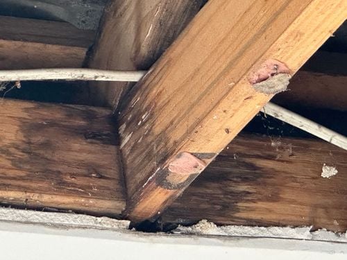

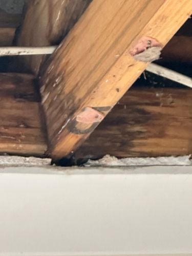

Hello, we had water leaking into our house from some cracked tiles but the problem has been remedied outside. I just had someone fixing the plaster where the water damage was inside the house and am concerned about the rotten wood that I saw through the roof . Is it going to be a problem if I leave this as it is, as long as we don’t get any more leaking ? Do I need to get someone to replace the wood in the roof and who do I get if I need to get someone. Thankyou for any advice

Unfortunately, it looks like you've got a potentially big issue on your hands. I would suggest you contact a licenced builder or engineer immediately to assess the damage. As I believe you've taken a photo of the underside of a roof truss and its adjoining members, it forms a structural element of your home, and the damage should not be taken lightly.

Thankyou for your advice Jacob, I’m so upset by it all, as I’ve had several tradesmen come to look at it in the last few years and it’s very hard to get help in my country town and I actually asked a roof guy to come and have a look yesterday and they said it doesn’t look like there’s any water coming in anymore but as you said it looks like a bit of work to get it fixed so I will have a call around to see who can come and have a look at it for me. And the pictures are me looking up at the hole in the roof before the plasterer repaired it so has since been fixed but not the inside of the roof which yes is a vital part of the house.

If I can offer some reassurance, it doesn't look like you are under immediate threat of roof collapse as there is still a good amount of material in place. But please, as a matter of urgency have this attended to, I would hate for a "potentially" big issues, to turn into a big issue.

Thankyou so much for your help today. You have confirmed what I was afraid of but as you said it isn’t in immediate danger of collapsing but we need to get it fixed so that’s exactly what I’m going to do. Thankyou again Jacob 🙏

I can clearly see water stained wood but what makes you think it's rotted, is the wood soft when poked with a screwdriver?
How long were the roof tiles leaking?
Any follow up from a Builder since you initially posted?
