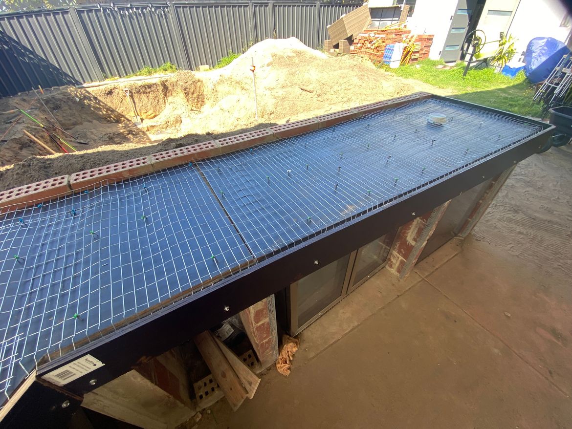

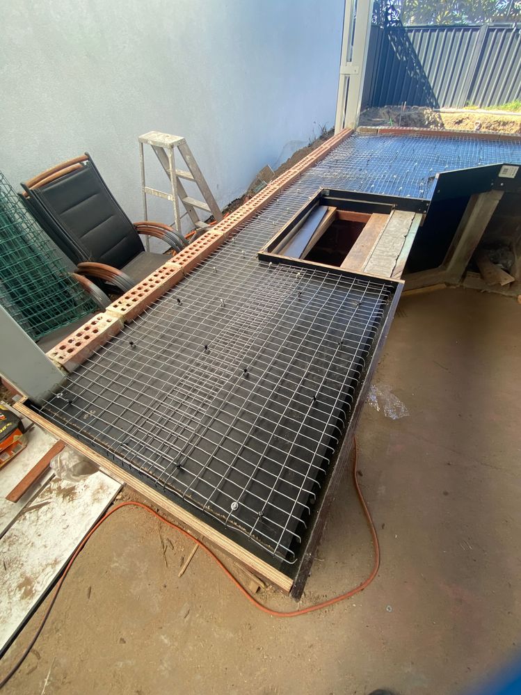

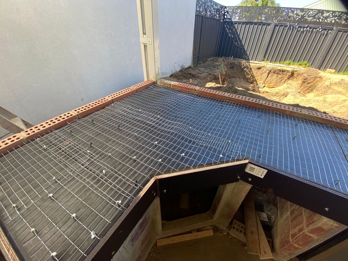

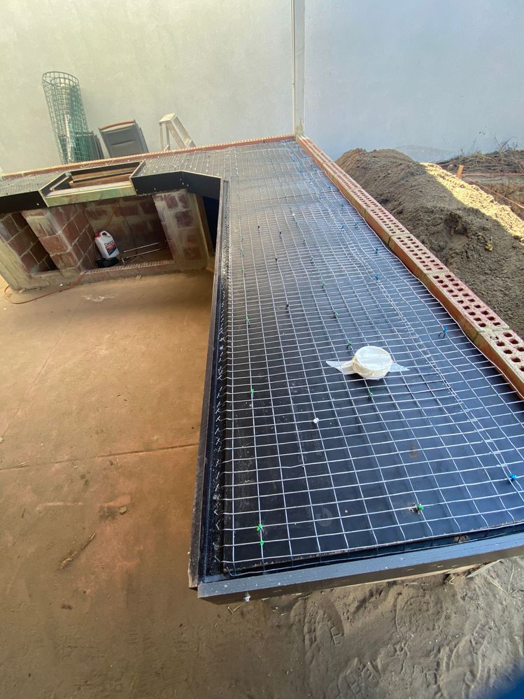

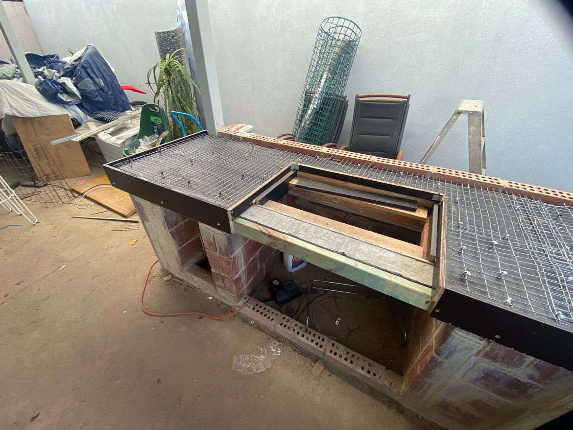

Getting ready for the mortar pour
Re: What Concrete Mix for Concrete benchtop?
Hello @snowgoose62
Thank you so much for the update on your concrete benchtop project. Before you start, I suggest having a quick read of this discussion - Concrete tabletop project by @markw. It has some very good suggestions on making sure that your concrete benchtop is free of trapped bubbles.
Please keep us updated with your progress, we look forward to seeing the concrete poured in.
