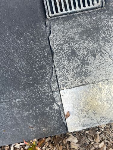

Hi there.
Can someone guide me step by step how to patch my driveway.
Thanks in advance 🙏
Hello @deanng3108
Welcome to the Bunnings Workshop community. It's sensational to have you join us and thanks for sharing your question about your driveway.
I suggest cleaning the crack with a bristle brush and detergent to remove any debris in the crack. Remove all the loose concrete bits that are just sitting in the crack. Once the crack is dry, I recommend using Earl's 1kg Concremate Expanding Cement and spreading it with a Pro Renovator 50mm Plastic Scraper.
My best advice is not to overfill the crack and keep it as level as possible.
Please remember to wear personal protection such as gloves, goggles and a mask when working on your project.
