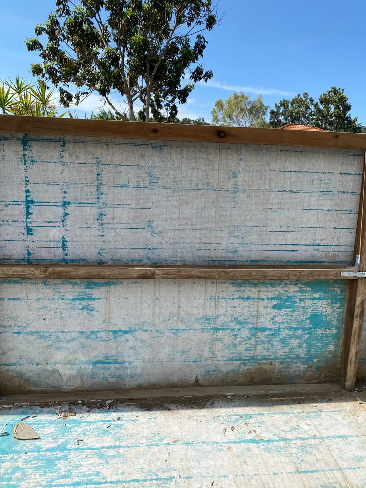

I'm tackling what hopefully will not be too big of an ask for my skillset. I have a 25 M long blueboard rendered front fence that is in dire need of a fix. The blueboard has long gone past it's best & is crumbling off the frame. My initial thoughts were to demo it & have a fencer erect something more aesthetically pleasing. Like everyone, finding a tradie is one thing, getting them to turn up is quite something else again. I removed the sheeting on the house side of the fence to inspect the frame. To my surprise, the frame was generally in good health so I decided to just strengthen the frame everywhere possible & it is now very sturdy. My intention is to just replace all of the sheeting, cover the joints with paper jointing tape & joint compound & then painting. What is the best way to fix the sheeting to the fence frame? Each fence "panel" is 2 x 2400/900 sheets, so 2400 wide & 1800 high. The pics might explain better than myself!

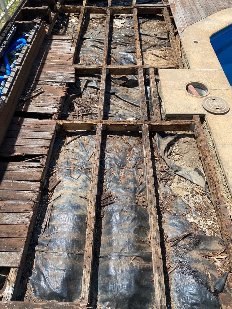

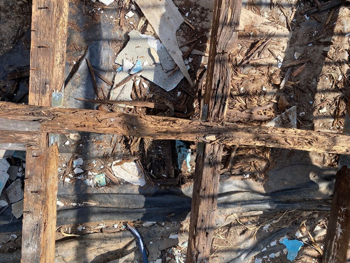

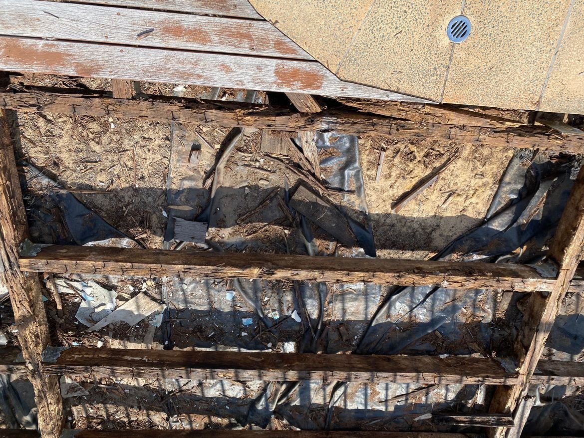

Onto my next & probably most challenging project, the pool deck. As per the pics, it's very obvious that the joists etc are far from serviceable. My thoughts are to just replace each piece of timber with a similarly sized piece of structural H3 pine & then merbau over the top. Any input greatly appreciated.

I would agree on the plan to reinstate the wall with new boards, tape, compound and paint. You will just need to remove or rebate those strengthen brackets that are surface mounted so the new boards can sit flush.

The deck unfortunately doesn't look salvageable at Allas the joist have lost to much of their structural integrity through rot and deterioration. It has been built correctly either as there are long spans where joists haven't been supported with stumps that would have cause the deck to bounce when walked upon. But the sub-floor frame does give you a great head start for a template of lengths and placement for a new one. And there are plenty of resources in the community that @Jason could share links to on how to rebuild it correctly. And with the new build, laying a product like Protectadeck along the top of the joist will maximise the life of the joists.

thanks for the suggestion. I'm tending to shy away from composite decking at this stage mainly because of the cost but also because the decking is in full QLD sunlight so retained heat is also a factor. With regards to the blueboard, what's the best way of fastening the sheets to the fence studs?

I suggest using traditional Paslode 30 x 2.8mm 2kg Galvanised Fibre Cement Nails to hang the sheets up. It is also possible to use the Macsim 8G x 30mm Fibre Cement Screws Galvanised or the Buildex 9 - 10 x 32mm Zinc Alloy 3 Star Head Fibre Cement Screws if you prefer to use screws. I totally agree with Nailbag regarding the state of the decking frame, I'm afraid it will need to be replaced as it has deteriorated very badly and can no longer be recycled.
I suggest having a look at these guides - How to build a low-level deck by @Adam_W and How to build a deck by @MitchellMc. These will provide you with ideas on what you need to take into consideration when you rebuild your deck.

thanks for the reply. Those Paslode Fibre Cement Nails look to be a great option. Am I able to hire a Paslode nail gun that is compatible with those nails? Is there any merit in coating the tops of the timbers on the fence frame & deck timbers with bitumen?
In my initial post, i must not have explained myself very well as I never intended to recycle any of the timber decking at all. My plan is to just use it as a template for new H3 structural pine joists & bearers with additional joists added where previously advised.

Unfortunately, there is no nail gun compatible with those nails.
Painting the timber frame with bitumen could assist in preventing water from sitting on top of it. However, you do have products like Protectadeck floor joist protection that are suitable for that job.
