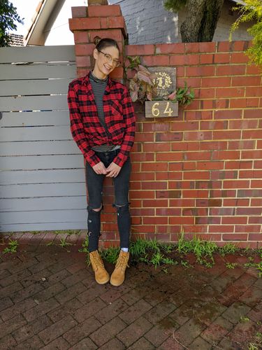

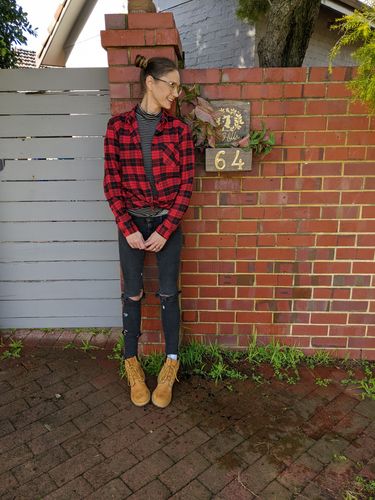

BEFORE... ... AFTER! But something is missing?!
Definitely needs something in it... but what?! Definitely needs something in it... but what?!

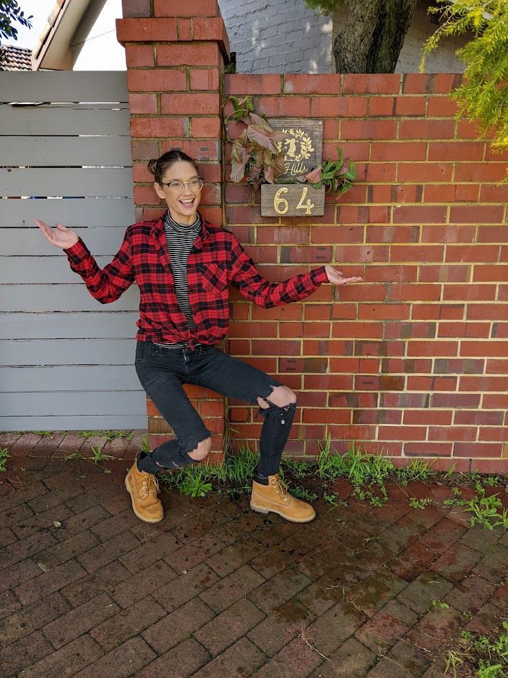

VOILA!!!!! My very first project and I'm so proud! Except it’s missing something???
A BUNNY!!!!! :) A BUNNY!!!!! :smile:FITS PERFECTLY! FITS PERFECTLY!

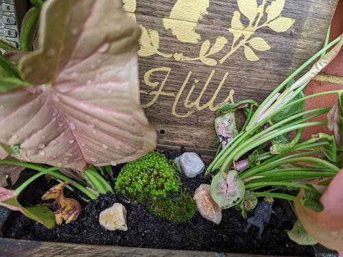

In the bare space in the middle we made a home for some new friends, adding some moss I found in my driveway and a few rocks from the garden...
Adding some moss and rocks made it more "homely" for these guys AND filled the gap! Adding some moss and rocks made it more "homely" for these guys AND filled the gap!
Peek-a-BOO!!! Peek-a-BOO!!!
TADAAAAAAAAAAAA!!!!!!! TADAAAAAAAAAAAA!!!!!!!
Pretty damned proud of myself... Pretty damned proud of myself...If I say so myself :) If I say so myself :smile:
