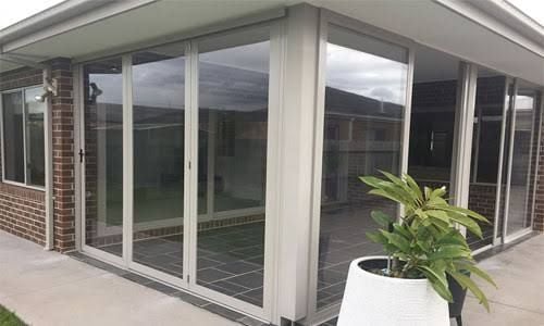

I have a 4x5m alfresco that I’m wanting to build in with windows and glass sliding doors. I’m interested to find out;
- do I need to put framing between the window and the brickwork?
- if I do need framing between the window and bricks how thick does it need to be?
- what is the minimum distance between windows (ie. 2 windows right next to each other)?
- also what is the minimum distance between windows when one is above another?
(note: photo is for attention only and is not the actual setup I’m looking for)
