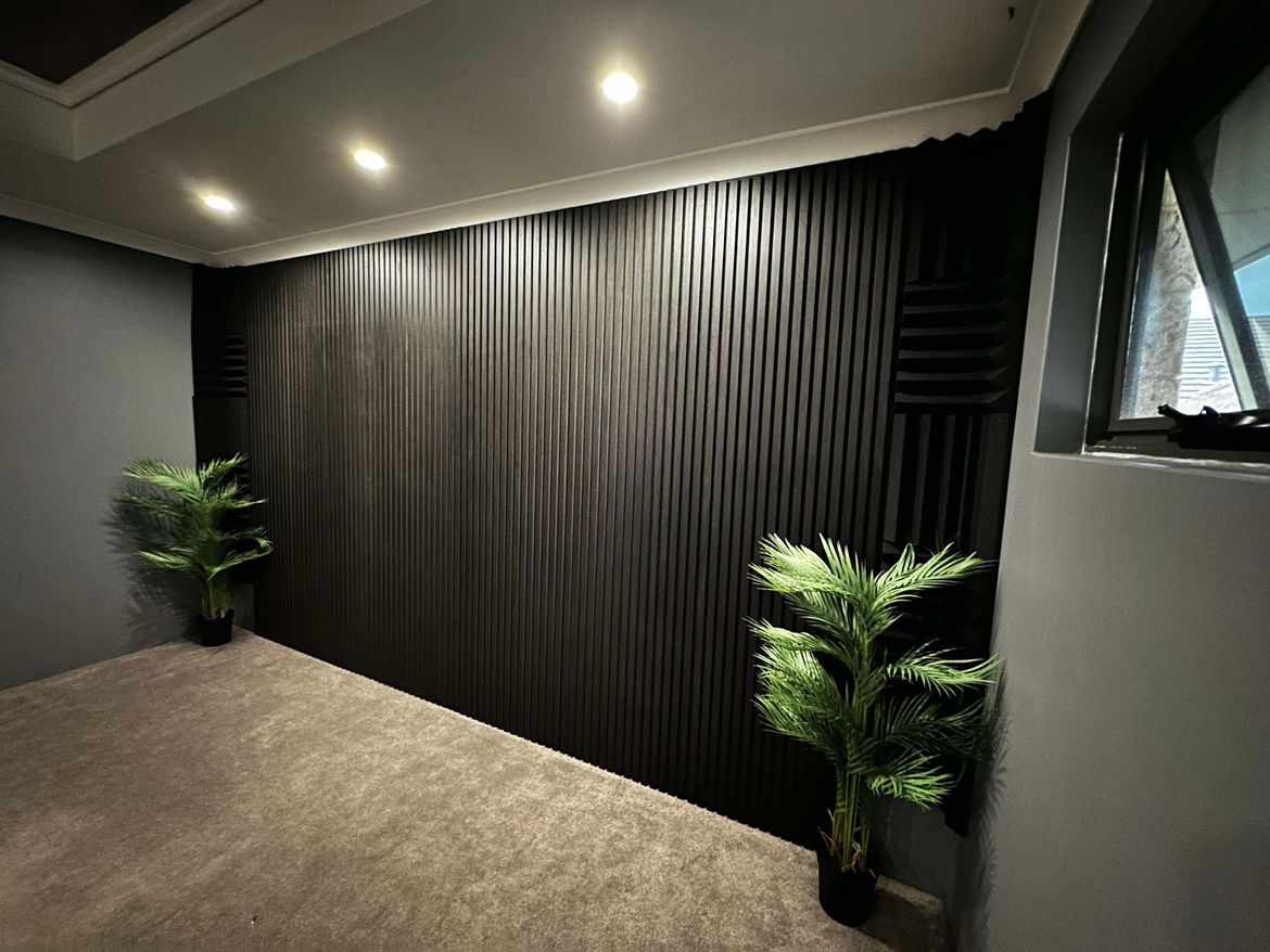

I recently installed 6 x prempanel black oak acoustic panels in my theatre/office and it looks great but the smell it gives off gives me a headache, learnt that this is called off gassing and it gives off strong VOCs that clearly affect me(cant walk into the room without getting a light headache)
I've given it a week and trying to ventilate it for the last 5 days with a fan and an air purifier on full and it smells the same as the day i put them on, just wondering if the smell eventually goes away or any ideas how to get rid of the smell and if even getting rid of the smell would get rid of the headaches, or do i cut my loses and just take them down.
ive seen people say leave them in the garage for a week before installing but saw that too late and i cut the panels and installed them on the day i got them using liquid nails, so if the answer is take them down then im not putting them back up even if the smell is gone. as I'm assuming the wall would be destroyed (would appreciate any removal of liquid nails tips so i can try avoid destroying the wall)
kind of disappointing as none of the reviews have had issues with this and i seem to be the only one, and the instructions don't say anything about VOCs or what to do about getting rid of the smell

I'm sorry to hear that the off gassing of the panels is giving you a headache. This is the first I've heard of this incident, and it seems a shame to simply remove your freshly installed panels. I suspect that the smells will eventually dissipate but, I'm not sure how long it will take. Instead of removing the panels, I propose investing in a high-volume air mover like the Dynabreeze 450mm Silver Industrial Floor Fan. I recommend keeping your windows open and placing the fan right in front of the panels to move the off gassing towards the windows.
I'm afraid standard domestic electric fans will not be strong enough to push the smell away. You can also use a Bear Disposable Paint Mask With Active Carbon Filter And Valve - 2 Pack while you are using the office. I suggest running the fan at full blast and keeping the windows fully open for another 10 days to see if the smell decreases. If the off gassing still remains at the same level, you can then start considering removing the panels.
In regards to disassembly, because you used liquid nails the walls will get damaged when you pull the panels off. You can try to use a Craftright 380mm Wrecking Bar to lift the panel but damage to both wall and panel will be unavoidable.

I would suggest the same type of fan that @EricL has, I have one I use all the time and its dried out my garage floor plus carpet nicely when I had water issues. I would run it for a few weeks and then see if its changed the scent. I would actually have thought there would be more scent from the liquid nails then the panels. I dont know of anything that could be used to mask the scent you describe as all you are doing is adding deodrant to a case of BO :smile: Wait a few weeks and see if there is less after using the fan and keeping it ventilated.
Pulling the panels off that you have attached to liquid nails will be problematic as @EricL has mentioend. It will leave tears, holes maybe in the plaster.

The smell is of wood and is very potent the liquid nails doesn't smell at all
I've changed to putting the fan up to the panels and the smell lessened but still is there
i went in store to double check i wasn't going crazy and the black oak while not as bad as my smell did smell the same
and the other oak panel didn't have the smell
I took a microfiber cloth and wiped along the panels in between the slats and it stained the microfiber cloth black
it looks like dust and even comes off when i run along it with my fingers, i tested scrubbing and using surface wipes to see how much i could get off and while the amount of black marks is less it still marks the cloth
I've vacuumed the panels above below and all over maybe 4 times now and still feels like I've made no progress
also the fan you linked was the exact fan ive been using its really good but then the second i turn the fan off the smell comes back in minutes
thank you for all responding so fast, i really don't want to take down the wall but its looking like the only option
knew the wall was going to get damaged if i had to take them off just was hoping it was gunna be years in the future not a week after i got the panels e44717309485ccab0864e40252610c28.jpgatt.PaOMI-OxC0Ci3RIrJYS5CPiWB2Y9ETAmq_rhVXzX5fg.jpg
plan on taking in an off cut of one of the slats to explain to the staff in person see if anyone can help me out

have you considered spraying the panels with one of the clear sealant spray packs? Though there would be some initial odour from the sealant for a day or so, but this would conceal the odour from the panels and save their removal.
i have had success in achieving the same result from a different high odour metal flaked product. .
@MitchellMc maybe able to suggest the most suitable sealant spray product for the panels which are primarily thick cloth backed panel with timber look vinyl wrapped strips.

I had a similar thought as Nailbag but then was more concerned over other chemicals eating/recting with the backing of the boards. Not sure how the sealants would react. Maybe a test piece beforehand?
