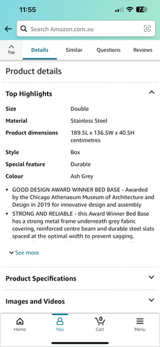

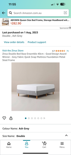

Hi Eric, thanks for getting back to me. Here are the details for the bed. All suggestions welcome! Best Wishes,
judith
Hello @Judith2
Thank you for sharing the details of the bed you'll be using. Because you are after a 4-poster set that can support curtains, I propose building it out of wood using 92 x 31mm 5.4m Moulding Pine FJ DAR Clear. You'll need a drill, drill bit set, tape measure, pencil and a hand saw.
