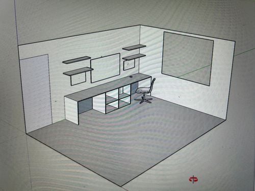

I’m trying to create a desk that is 3400 long. I’m looking at these panels
bunnings panel
or these
bunnings panel
I have a couple of questions.. how can I join the pieces of wood together to make 3400? Just wood glue and pocket screws? Is 18mm thick enough? How can I attach the sides so you cant see screws? L brackets?
What tools will I need? I only have an angle grinder and a drill available, do I need other things? Clamps? Does Bunnings cut the wood?
I’ve attached a photo. The side panels will be the same wood and the drawers/shelves in the middle will be bought separately

Afternoon (just)  @joshs
I love those solid panels from Bunnings. I think Kreg screws, dowels and biscuits would all work, based on believing you are going to support the join with those open cabinets seen in your diagram.
That diagram also suggests back panels which would support the ends - so I can't see a need for 'L' brackets?
"drawers/shelves in the middle will be bought separately"
I was thinking you get this first, to determine the end heights and where the join will be supported.

Hi @joshs
Looking at your diagram I am going to assume the two panels join at the centre where there is the middle up right of the cupboard supporting the join.
I would not join the timbers just push them together and screw them in place.
I might put  either a double wall  timber in the cupboard so  each  panel end is supported fully rather than half and half sharing the single middle cupboard  divider.
Or use the single divider and screw in two timber beads 30mm x 19 mm square approx at the top for panel support.
Too answer your question  to attach a timber  bead to the inside of each end appox 30 x 19 timber pine screw  and wood glue it so it looks like an  upside down  'L'  shape. That little lip on the L shape drill a couple of holes through it for screws to come up from the  underside of the desk  panels and they will be hidden,
You will need cordless drill, pvc Wood glue, saw to  cut wood or a good  tape measure to get bunnings to cut wood for you they will do that.
The  weight of the panels will sit them in place on top of the cabinet.

The diagram has shade at the back but it will just be wall or vj panelling. Would Bunnings cut those solid panels? Because would need an extra one cut for the two outside legs

I suggest using the Practa 2200 x 600 x 26mm Acacia Timber Benchtop. Because it is 26mm thick it will allow you to use the Kaboodle Benchtop Joiner and the Taskmaster 120mm Bench Top Connector. These joiners require a minimum benchtop thickness of 20mm.
In regards to the side panels, I'm in agreement with @Noyade's assessment, if the ends will get extra support there should be no need to install brackets. However, if you feel that it is necessary for the tables stability you can install them for extra rigidity.
The shop saws will cut the EasyVJ panelling, but keep in mind that you'll need to cut them again if you want the cut clean and precise. I'm sorry but they will not cut the benchtop panels as the saws are too rough, and it's not made for precision cutting.

Thank you kindly Eric. How can I cut the benchtop panels? The diagram doesn’t have a back panel, it’s just the wall, so would it need brackets or could I just some wooden dowels in the top of side panels and drop the benchtop top?

You can cut the panel with either a hand saw or a circular saw. If you don't have experience in using either tool, I suggest doing some practice cuts on offcut timber pieces.
In regards to the side panels, it would be good if you could screw them to the main bench top, but if that is not possible, I suggest using an angle bracket to add extra support for the table.
