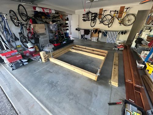

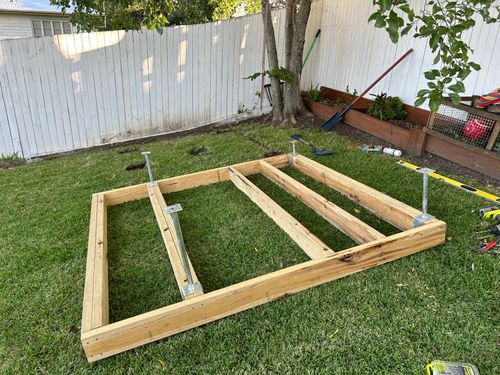

The frame was assembled upside down in the garage and the stirrups were attached

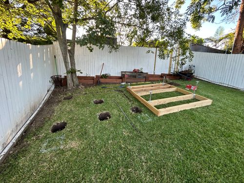

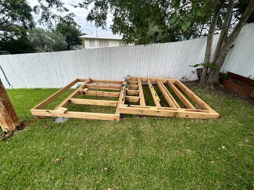

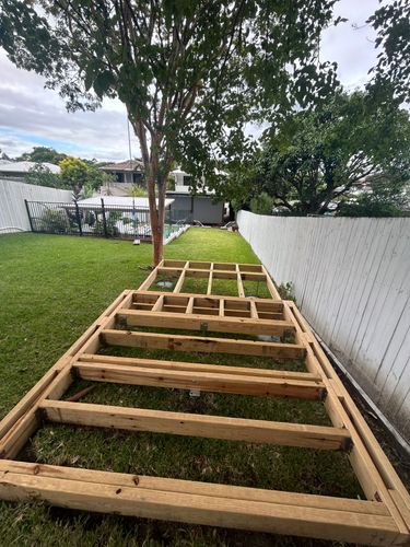

Holes were dug insitu and the frame was lifted in (very heavy-needed extra hands)

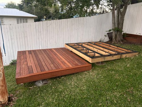

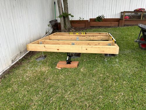

The frame was levelled and concrete was mixed and placed into holes

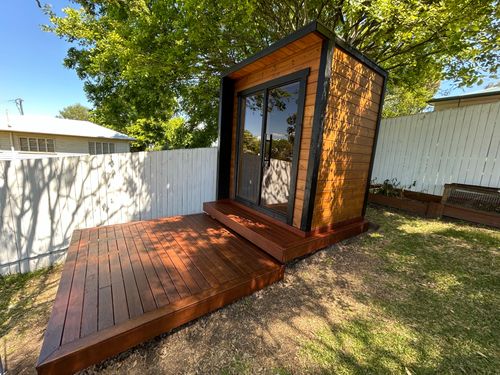

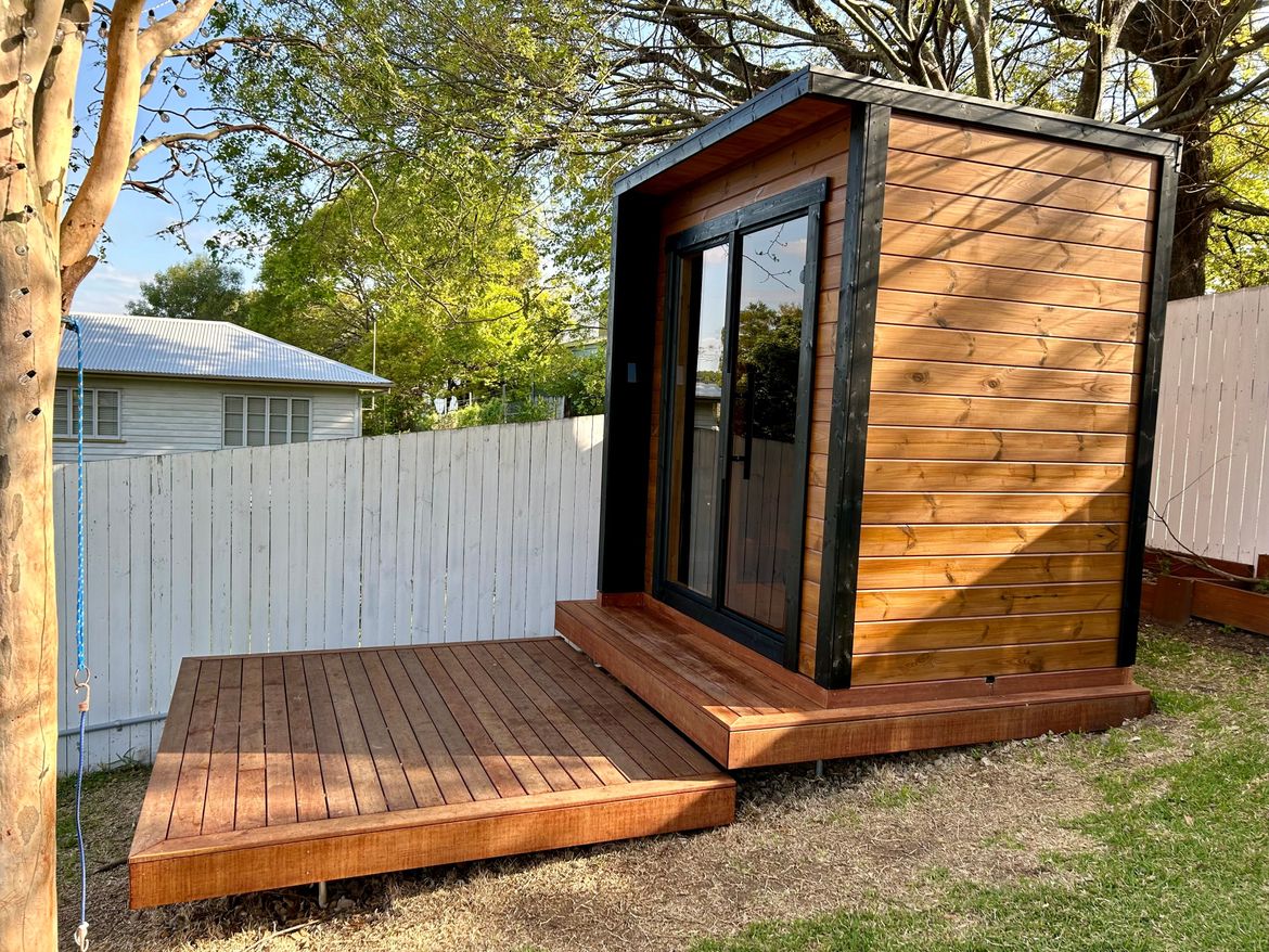

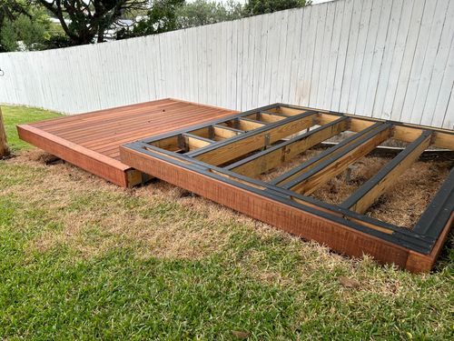

After curing, I finished the deck with joist tape and the 90mm preoiled merbau decking

Thank you for sharing your sauna deck project, it looks fantastic.
I like how you constructed it all in one piece before levelling and concreting it into place. This is a great way of getting everything perfectly square and in line on a nice flat surface.
The Merbau looks fantastic and complements the sauna beautifully.
Using the car jack to keep everything level while the concrete set was also a brilliant idea, making it very easy to tweak your levels to get everything perfect.
