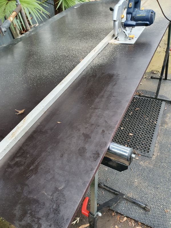

I'm a poor man.
Still using an aluminium straightedge and clamps.
Today was a 2.4 metre cut. At that length - the straightedge does flex in the middle - maybe 1or 2 mm.
What do you guys do for cuts like this?
My back is no good - I can't do this sort of thing on the ground.

Hi @Noyade,
While I do have the clamp-on straight-edge device, I do use a length of 25 x 65 mm RHS aluminium section.
I have never had this distort (bend) once while making a long cut through a full sheet of 18mm plywood.
Obviously the wider part of it is clamped to your timber/board, it is the width that makes it hard for it to delineate during the cut.

Hi @Noyade
I have the same exact guide at home, I usually put a piece of timber in the middle of the guide and clamp it to the board to prevent the aluminium from bowing in the centre. Not the best solution, but it's what's working so far.

Hi @EricL
Clever idea above. I was even thinking of a small screw midway.
Hi @MikeTNZ
"25 x 65 mm RHS aluminium section."
Yes, a better section than mine - which is only 25 X 40mm. I will look into that.
These sorta very long cuts are very rare for me though.
Hi @CSParnell
Good eye there. A big ole 230mm/2,300 watt GMC saw. I bought this from a pawn broker for $20 a few years ago - unused and still in it's original box. Very heavy.
