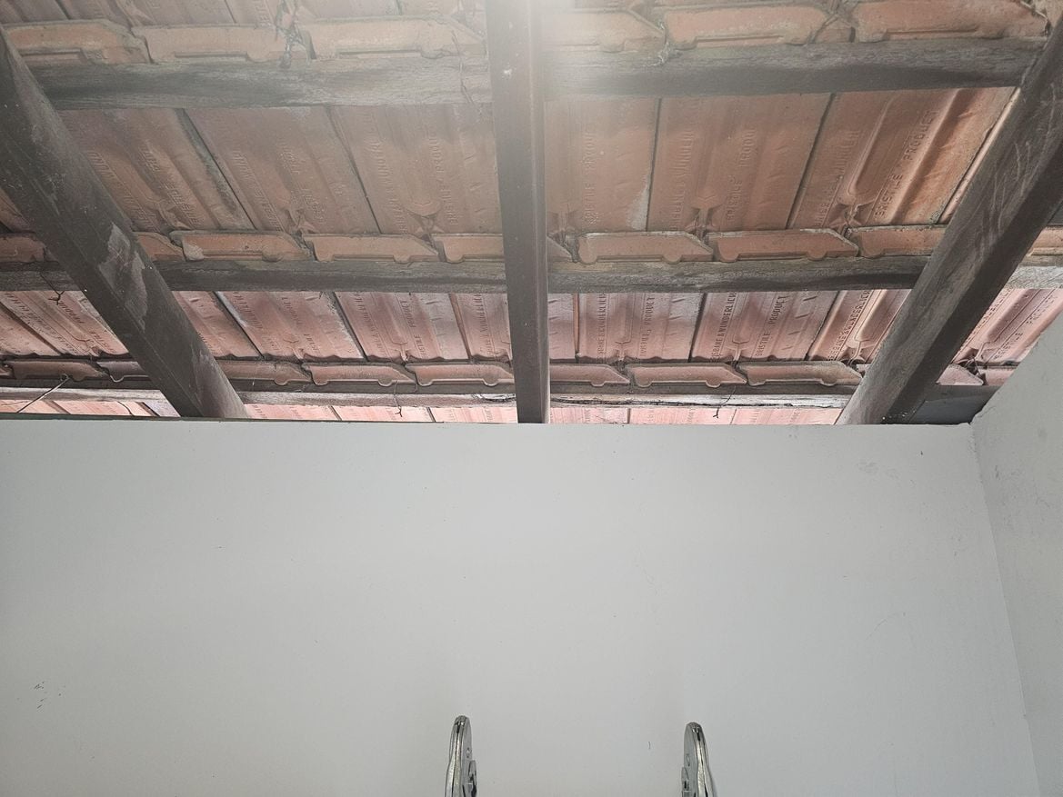

Hi all,
Hoping for some advice, I've spent days looking through google and am at a loss.
The house we bought had a outdoor room/shed added on to the porch, just an extension really. They basically just added in two walls and called it a shed. The issue is that they have left a gap between the newly installed walls and the tiled roof (about 18cm) and I can't figure out the best way to fill it.
Doesn't need to be fancy, as it is being used as a shed but just something that will keep the dust, wind and weather out. Am not expecting it to be 100% sealed, just enough to keep out dust and anything that the wind might push up under eaves. As the eaves are hanging down on the opposite side of the wall, not a lot comes through, but on windy days the dust comes straight in and I'm imagining the rain will also when we get some gusty storms.
I was thinking of just stuffing some Earthwool Insulation up there as I just can't think of anything else that's simple and easy.
Any suggestions are greatly appreciated :smile:
Thanks!

Hi @Denaz,
I tend to agree with @Dave-1 that you should persevere and use the screws. Liquid Nails is an adhesive, so its strength depends on the surface preparation and the type of materials being bonded. In general, screws provide a more reliable and durable hold, especially in applications where significant weight or stress is involved.
If you are struggling because of the hardness of the timber, you should certainly be predrilling pilot holes, as hardwood, especially older stuff that's had a long time to dry out, is extremely hard and will snap your screws.
If you are struggling because of the angle, you might like to try using a Ryobi 2-Piece Right Angle Drill Adaptor to get into those tighter spaces.
Let me know what you think.

Thanks @Dave-1 and @JacobZ , really do appreciate the replies!
I will keep going then! I guess I was also a little concerned in damaging the roof beams and causing a split or something major like that. I assume that predrilling the holes would prevent that? Last thing I need is to have to replace those big beams haha
And @JacobZ I actually just bought a right angle adaptor... although it may have been the cheaper craftright option lol
Thanks again!

Just paranoid with the timber beams as the house is very old, so wanting to be as careful as I can and not create any more problems. The pre drilling gives me a bit more confidence that I won't split the beams or break the screws though. I put up some camera not long ago and did not predrill... and that was a difficult process to say the least lol

"Am not expecting it to be 100% sealed, just enough to keep out dust and anything that the wind might push up under eaves."
Same here. Under a carport and a back verandah area. Not a perfect seal - but enough to reduce cold wind (like a night tonight) and support battens under the carport.
All done with treated scrap wood and Selleys Rapid Cure Ultimate Strength glue.
Those small vertical windows with light shining through under the carport job - are hand spaces for my fat hands so I could perfectly position the pieces.  😊
Thought of covering them later - but decided against it. Both areas were done about seven years ago.
Cheers.

@Noyade I totally missed your reply sorry! That looks great and good to know about the glue too. I ended up going with the brackets but I tell you, my poor hands copped a beating! Going to be pulling out a couple of splinters tonight 🤣
Thanks again @Dave-1 , @JacobZ and @EricL , I stuck with it and finally got it done! It was a pain in the backside that's for sure, a couple of beams turned out to be a bit warped so getting to timber the right size was tough. The right angle drill adapter really came through though, made things a lot easier.
Anyways, bit of paint and a bit of spray foam for the gaps and it's pretty much done🥳
