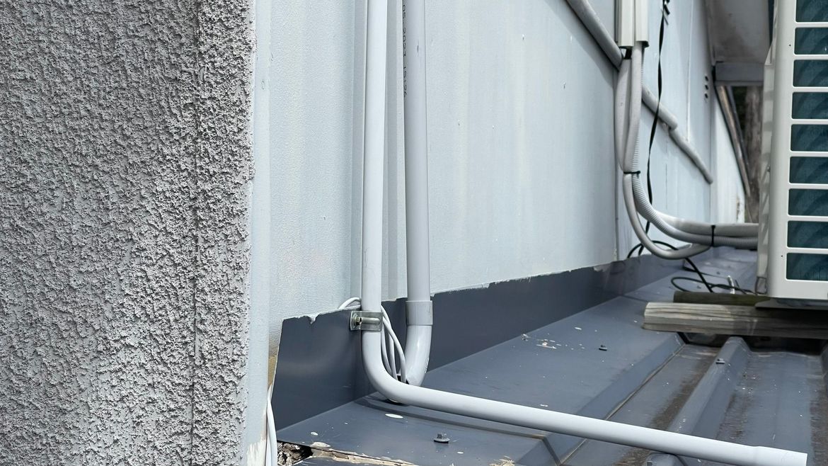

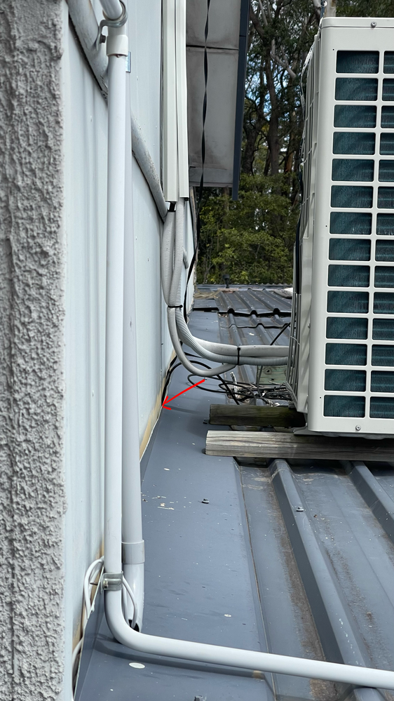

I am looking to fix a gap between the exterior wall and carport. The gap is substantial (50-100mm) in some places.
Looking for any advice on the best way to approach this.

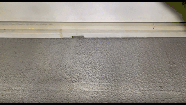

Pictures below show the roof and the leaking ceiling underneath. There is no long term damage from this that I can see but looking to add some pegboards in the carport and can't while the water is running down the walls.

The issue appears to have been created or exacerbated by whoever pulled the flashing away from the wall to route the electrical cables behind it. I can't imagine any of that is compliant. I advise contacting an electrician and having them complete this job to a compliant and safe level. Instruct them that they'll need to complete the work and remove the wiring from behind the flashing. Once they've done so, you can apply Sikaflex 11FC behind the flashing and fix it back to the wall.
It would be near impossible to adequately seal the flashing as is, and the repair of this really needs to start with an electrician routing these cables in a suitable manner.

Hey @MitchellMc and @RossK unfortunately that wiring as it stands is not compliant for 2 reasons, 1. It is not mechanically protected, 2. It is UV exposed.
This needs to be rectified by a qualified electrical contractor so that it meets Australian/ New Zealand regulations.
If left unfixed there could be potential for risk for short to metal and creating a live metal structure.
Please do NOT DIY you risk potential harm and loss of insurance.
