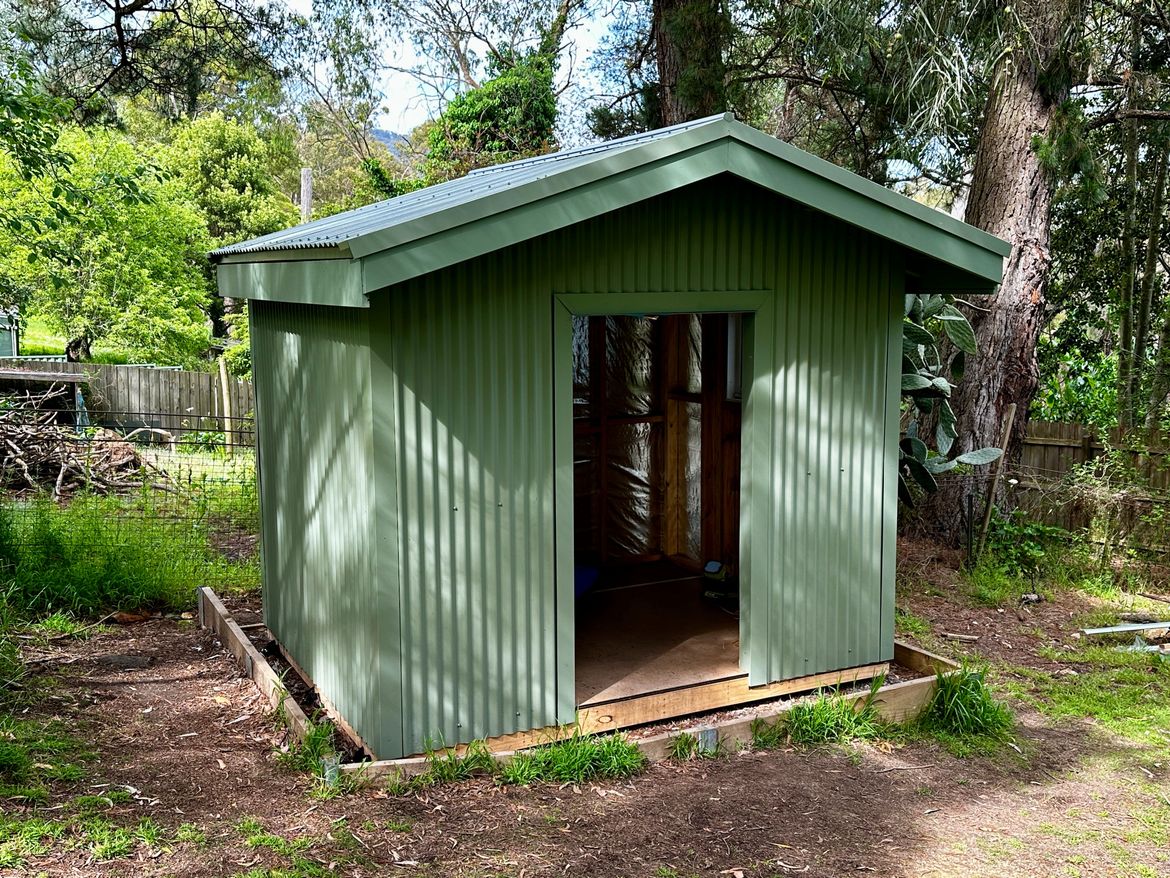

What a thing of beauty @mikebarker! Love your work! That must feel amazing to get to this point. You've done such a great job.
Many thanks for the update.

@MitchellMc Yeah I'm really pleased! I just need to make a door, planning to either 90 x 45 or 90 x 35 pine for the main door structure with a plywood sheet on the front, clad with colorbond to match.
What plywood would you recommend? Treated plywood seems hard to come by/really expensive. If there isn't a better option, could I seal the plywood sheet for some waterproofing? It will be mostly covered with colorbond but might have some water going on it.

:laugh: Cheering! Thats a nice looking shed! :smile: It blends in nicely and looks solid!
Being a door I would go for treated plywood as a backing. You have put so much effort into the shed imagine the frustration in a yeras time when the cheaper plywood expands a little and your door isnt as easy to close as it was comes to mind 😕 I know towards the end of a project where we just want things done and to stop costing :smile: it is tempting. I just find it bites us in the you know what long term.

@Dave-1 Thanks! Yeah blending in was the idea, I would have preferred a dangerous-looking darker one but the missus favoured a blend in... plus a darker one would have cooked the contents in summer!
Ok noted, I'll get some treated from somewhere. 9mm ok you reckon? I can 12mm too.
@EricL Ah great suggestion! But I'm afraid I purposely made it a wider door so it's 1150mm-ish much wider than any of the off-the-shelf doors from what I can see?
