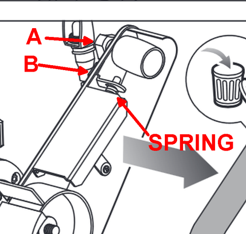

Here's my 5c thought after looking at the PDF on the Bunnings site.
Two knobs - A and B.
Take the starboard cover off.
Unlock A and pull the roller down against the spring (assumption).
Re-lock A.
This now allows you to fit the belt without fighting the spring/roller.
Fit the belt. Correct direction.
Release A.
The belt automatically tensions with the spring rebounding.
Now, the question is - do you re-tighten A - really tight? Or just enough for knob B to be able to adjust the tracking?
I think the latter.
Hard to tell from the instructions.
But based on you saying "the tension is loose" - is your spring not providing enough upward thrust?

Since installing the new belt, did you turn the knobs to adjust the tension? Have you confirmed that the belt is the correct length and size?
I would think both A and B adjust tension. B is likely the major tension and A the minor and tracking. A governs the roller at the top and typically when un-tightened allows the roller to dip to the right. When tight it brings the roller perpendicular to the left of the machine. It's this dipping of the roller that causes the belt to track to the right or left.
