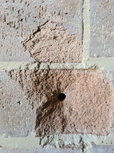

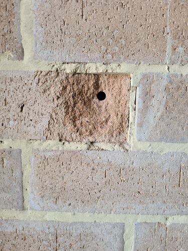

Hi
Does anyone know how I can fix/repair this, inside garage wall.
The bricks are hollow.
Thank you
Hi @MegzC,
