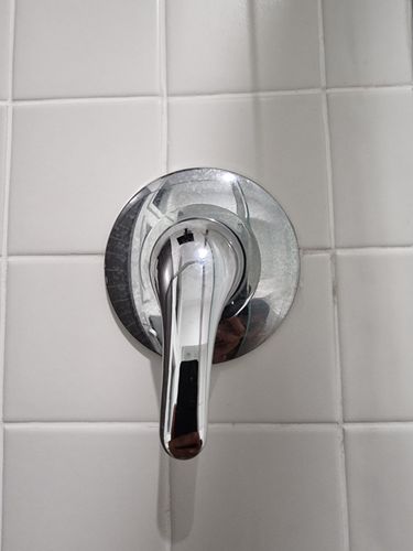

Hi Eric,
Thanks for your reply. In that case, I will have to return this tap to Bunnings as I want to install a tap myself easily without calling a plumber. Can you please tell me what is the cartridge size of my existing tap by looking at this attached picture? I need a tap mixture which I can easily take the old cartridge out and replace with a new cartidge and the new tap.
I am not trying to repair anything, just want to change the look with a new black tap. Thank you.
Hi @Jamil,
Thanks for clarifying. Unfortunately, shower mixer taps don't work that way. They're not like a sink tap where you can just easily remove the tap and washer and replace it with a new style; it's a little more involved than that. As @EricL mentioned, the whole assembly needs to be replaced, and you need a plumber to do this for you.
Perhaps you might like to take a look at this wonderful project by @lifestylebymari, where she shows how to update your existing chrome tapware with spray paint: Spray painted tapware. She achieved some wonderful results, and it looks like you could too.
