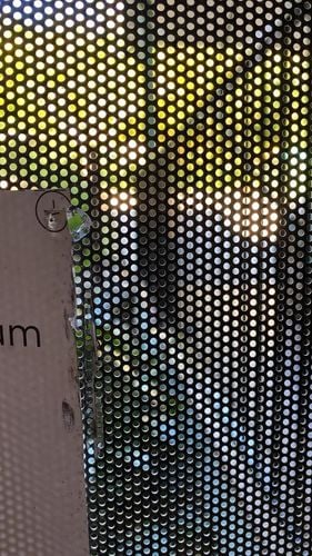

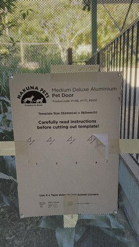

I need to cut a hole in the security mesh to fit a dog door. I bought a new ryobi angle grinder and a couple of grinding discs. Every time I try to cut the security mesh the grinder cuts out after a few seconds and is mot cutting through.
Maybe I need a stronger disc?

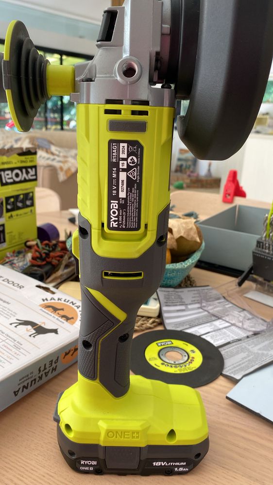

Hi @kymmccarthy11,
Thank you for the follow-up photo.
I'm fairly confident that the issue you are having is because the 1.5Ah battery is not up to the task.
I'd suggest picking up a larger battery like I suggested earlier.
If you have any questions, please don't hesitate to ask.
