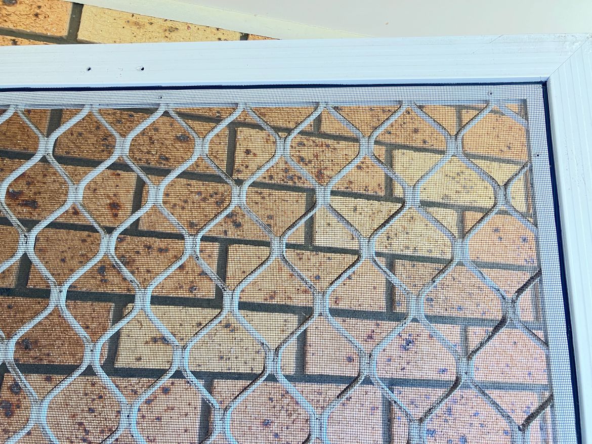

Looks great - did you remove the wire mesh first? If so, how - I want to do mine but can't see how to remove the mesh///IMG_1142.JPGIMG_1143.JPG

It would make sense that they removed the mesh first and then replaced it after painting. To remove your mesh, you'd dig out the rubber spline that retains it in the frame—it's that black rubber. Look around the perimeter until you find the joint in it, and use a small flat-head screwdriver to pull it out. Once you have the end out, you should be able to pull the rest out by hand.

That is correct Mitchell. @Nickim1, The screen was removed and replaced after spraying.
