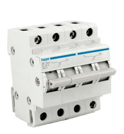

Hi team,
Is there an Electrician here who can tell me if this Mains Power / Generator Power changeover switch is big enough to power a household?
Total useable wattage would be approx. 14Kw..
Equipment to power would be..Aircon.7Kw...fridge..microwave..oven..griller..small appliances..
The changeover generator is a 9Kw. petrol generator..
The switch is a Hager SF263 Changeover Switch 2 Pole 63 Amp.240V. 50Hz. Din Mounted..

All good Prof,
Oddly enough, I went to a house fire the other night (I'm a volunteer Station Officer) and the guy had bought some gear and rewired his own switchboard.
He wouldn't say where he got the gear from (not being a qualified sparky), but his wife said he got it off Aliexpress............
I'm going back there tomorrow to try and fix it all up.
Just be bloody careful folks, this guy only lost some of his hallway, before the fire was discovered.

Mate there's a reason you must used licienced tradespeople & I'd suggest your about to find out if your doing this work yourself. Please listen to qualified advise as you might just kill yourself or someone you love.
I've seen far to many home electricians jobs & a few burning results. This is an industry not to take safety lightly.

UPDATE...
I don't think I ever mentioned what I finished up doing about changing mains power to generator power..
I gave away the idea of using that Hager changeover switch..Instead my Gardener who is also an allround handyman..ran two underground cables from the generator to the house..
One cable goes directly to the air-con..and has a simple high wattage throw over switch cleverly hidden in a wall cavity behind a picture on the living room wall..and the other cable connects to the outside of the house with a through put 3 pin double socket where I can connect any of the appliances..
I've used the setup several times now and it works well...
