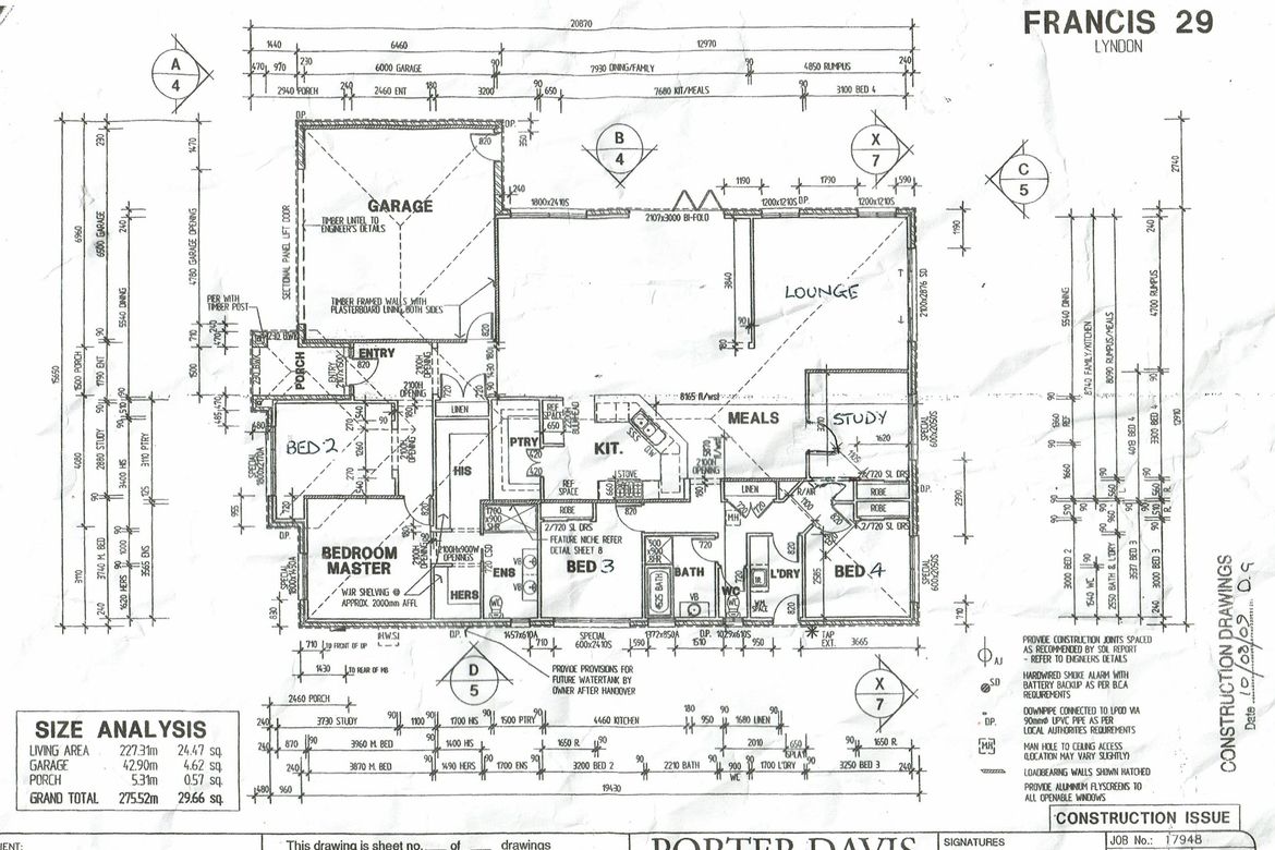

Our house is only 13 years old, but our family needs have changed.... and we really need to install a 3rd toilet.
I have attached our house plan as it is at the moment. The house is on a concrete slab.
An option I thought of, would be to move the bathtub out of the bathroom, and install a bathtub into the ensuite. Then we would have room in the bathroom to install another toilet. Thinking to move the door of the WC further out to flush with the passage, so we can add a small vanity unit into the WC.
If adding the bathtub would make the ensuite too cramped, we are quite willing to include the smaller WIR as part of the ensuite.
But am needing advice and assistance in what layouts would work!

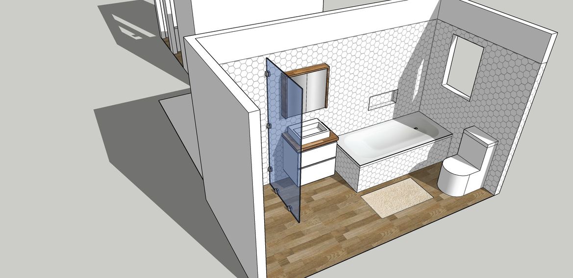

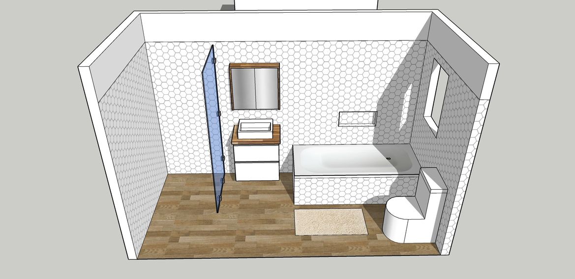

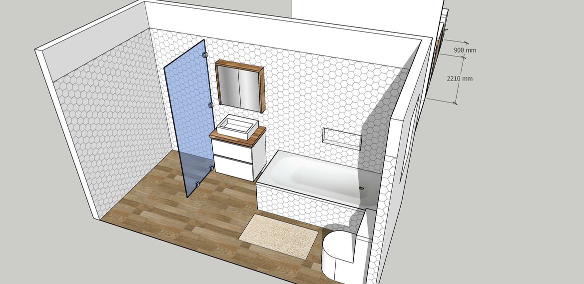

Hi @EricaW
As promised here are your updated drawings with the bath installed near the toilet. Please keep in mind that the vanity space is conservatively around 1 meter only. I've placed a 600mm wall-hanging vanity to give you an idea of what it will look like with the remaining space.
