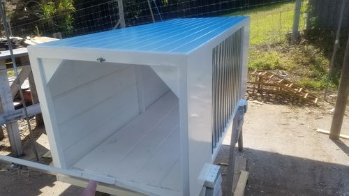

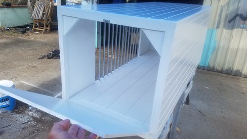

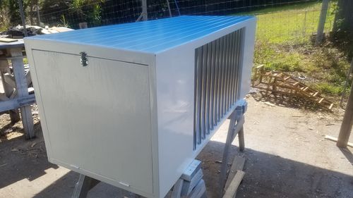

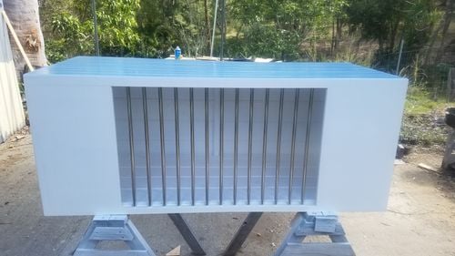

Like most things i make, there were no plans for this, just a picture in my head. Apart from the chrome curtain rods for the bars on the front it's all wood. With a box frame of 30mm x 30mm pine it's covered with pine panels on the roof, floor and back wall. Either side of the bars on the front is 18mm pine utility panel. The doors at either end are 12mm ply. It's spray painted with 4 coats oil based enamel. It now has two dog beds inside and it is home for two Dachshunds.

Many thanks for sharing your project with the community. That looks extremely well made, is it all made from timber as it's hard to tell given the incredible finish you've achieved? I trust our members will be interested to hear some more details on the construction and materials used. Did you have a plan that you could share at all?

Thanks Mitchell. I've edited the post and added a brief description of the build. Sorry there's no plans. Another project planned in my head.
