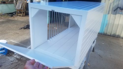

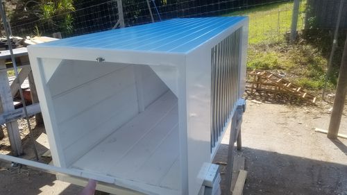

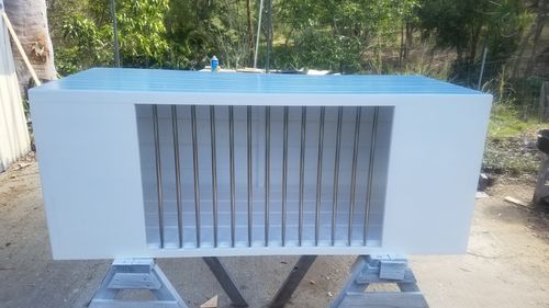

Like most things i make, there were no plans for this, just a picture in my head. Apart from the chrome curtain rods for the bars on the front it's all wood. With a box frame of 30mm x 30mm pine it's covered with pine panels on the roof, floor and back wall. Either side of the bars on the front is 18mm pine utility panel. The doors at either end are 12mm ply. It's spray painted with 4 coats oil based enamel. It now has two dog beds inside and it is home for two Dachshunds.

Thanks Mitchell. I've edited the post and added a brief description of the build. Sorry there's no plans. Another project planned in my head.
