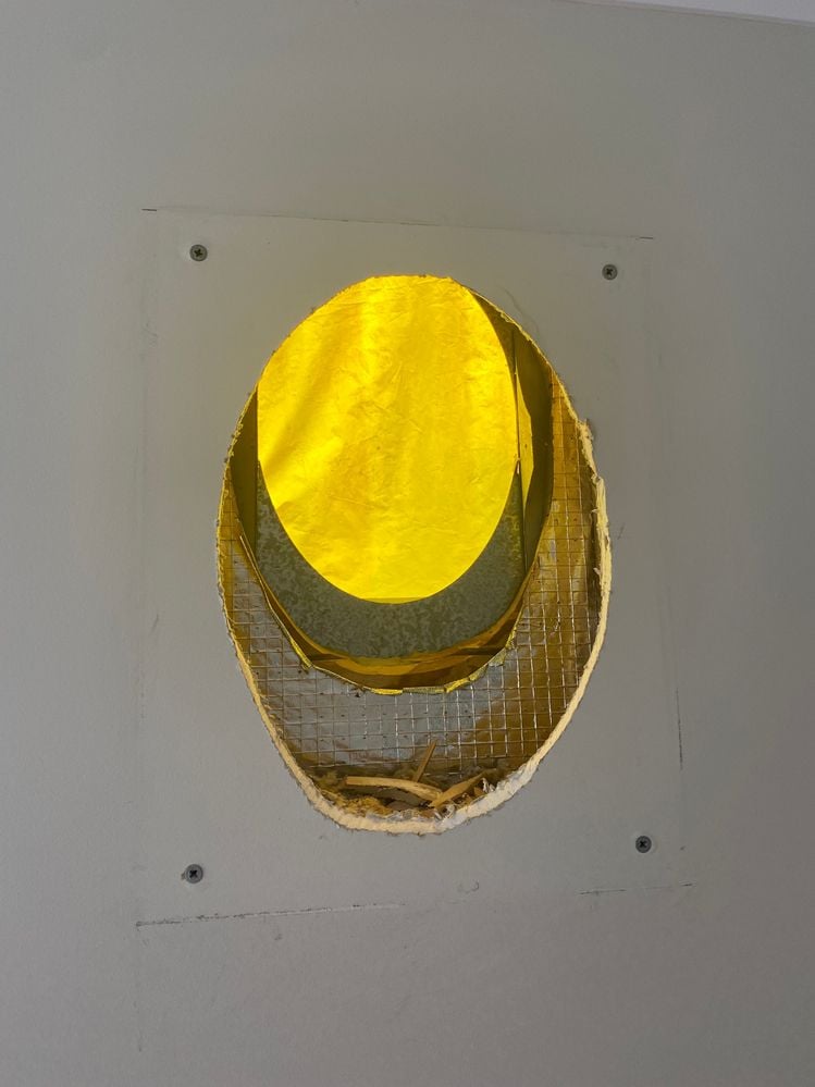

I've had a heater removed and now I need to patch the hole left by the flue. What's the best approach here for the inside? Can I patch the gyprock without having a beam behind it or should I cut a larger hole so that it has some beam there? Any tips appreciated!

However, if you wish to patch the hole in the ceiling, I suggest using Gyprock CSR 530 x 530 x 10mm Mini Plaster Repair Panel in combination with Gyprock CSR 2.25kg Less Mess Multi-Purpose Joint Compound to cover and repair the hole in the ceiling.
Place a piece of timber that's slightly bigger than the hole and position it in the centre and screw the ends in place. Trace the size of the hole on the repair panel and cut it carefully so that it fits perfectly into the hole in the ceiling. Screw the repair panel to the piece of timber you placed in the ceiling. Use the joint compound to cover the gap and screw heads. Let the plaster cure and sand down in preparation for painting.
