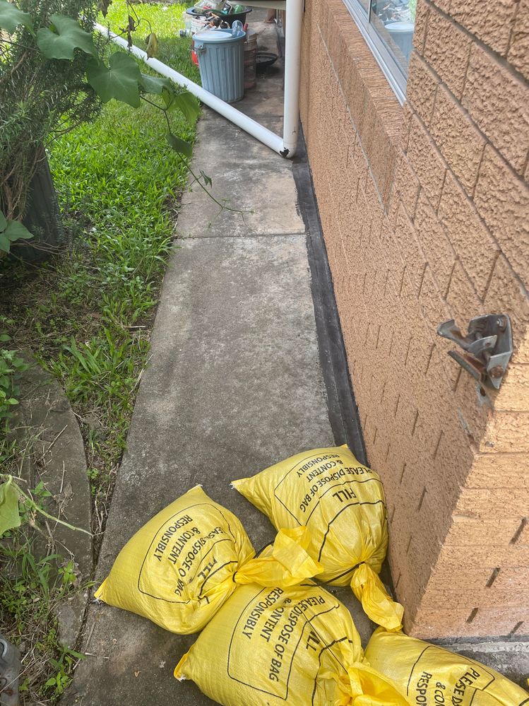

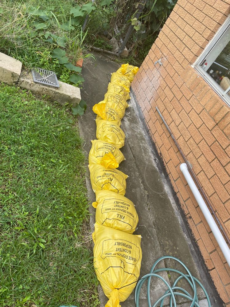

Hi, with the recent "rainbombs" in Queensland I have had water leaking into the house downstairs. The ground level outside at the greatest variance is about 5 bricks above the height of the inside floor at the corner and height taper off on both ends of the wall.
Outside has a concrete footpath that wraps around the house and I have observed water sheeting off the footpath but nothing major I can see that goes into the house. I believe water is coming in when the ground has soaked too much water and leaking thru the brickwall under the footpath.
What I am thinking of solving the issue is to remove the footpath, have earthworks down to 100mm below the level of the interior floorput with these channels ( https://www.bunnings.com.au/everhard-3m-easydrain-polymer-grate-and-prejoined-channel_p4770175 ) against the house wall to divert water and a retaining wall on the otherside.

Thanks @EricL  photos added.

The water is coming from my backyard and as there are no stormwater drain on that side of the house its all coming down towards my house.
If the plan is to have the poly channel against the house wall and a french drain (wrapped agi behind the retaining wall) behind the retaining wall.   connected to the stormwater drain at the front of the place using PVC.  Would this be sufficient or should I have another poly channel on the retaining wall side as well?  My thinking is that the french drain should take most of the water that potentially be raising due to saturated ground and the channel will take away surface water close to my house (which I observed there wasnt alot of even during one of the short but heavy downfall).
