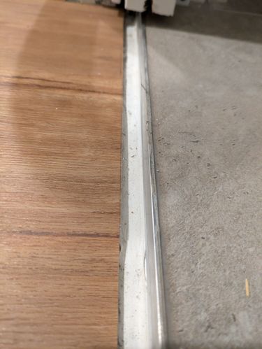

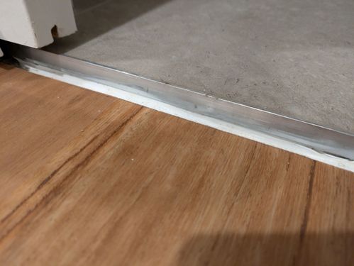

Hi, I have just laid laminate flooring and need a solution to add a trim from where the flooring meets tiles. They are not at the same level. I have left a 10mm gap. Not sure what is best option

What is the difference in height between the laminate and the top of the transition?
If it is roughly 10mm you can likely use some 8 x 8mm Tri Quad Tasmanian Oak or 12 x 12mm Tri Quad Tasmanian Oak to cover the transition. This could be cut to length and stuck in place with Liquid Nails.
Another option is this Hanwood Blackbutt Vinwrap Floating Floor Quad Trim which looks to be very similar in colour, however, the size might make it unusable in your application.

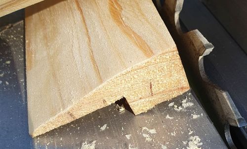

As per @JacobZ 's thoughts @LeopoldProjects
Plus - If you have access to a table saw, you could rip the profile of your choice which would also fill that 'trenched' area between the boards and vertical aluminium.

Hello @LeopoldProjects
In woodworking, a rip-cut is a type of cut that severs or divides a piece of wood parallel to the grain. Put in simpler terms you are cutting a strip of timber that is in the direction of the timber grain. So, if you only want a 50mm piece, then you rip-cut it from the edge of the panel of your choice.

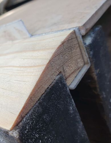

Morning @LeopoldProjects
As per @EricL's description - keep 'ripping' until you match the profile you want dimension wise.
To my eyes - your board height and aluminium height would accommodate something like this in profile.
A large bevel would help prevent tripping - hopefully.
This was just scrap radiata - hardwood would be better.
