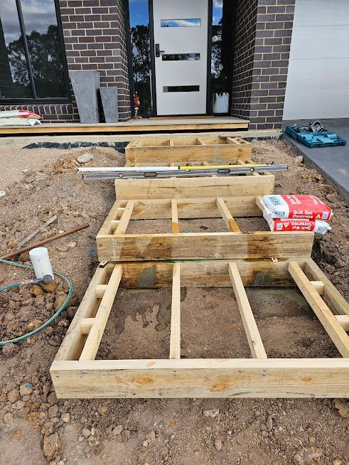

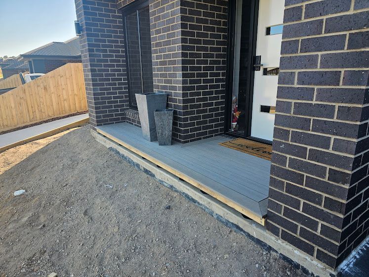

We made the frame for the deck out of 70 x 45 treated pine, then used the pedestal feet to level it up. We picture framed it first then filled in the middle.

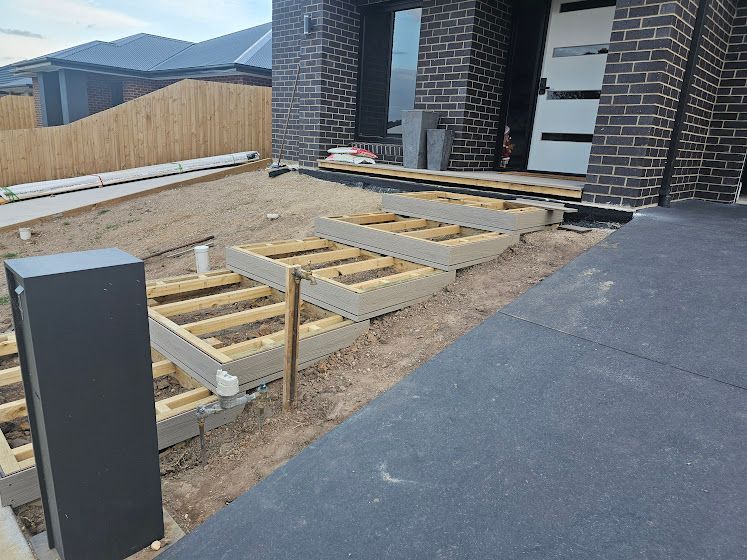

Steps were made using 200 x 50 treated pine sleepers for the outer sections, then used 70 x 45 treated pine for the joists. We screwed it all together using batten screws. We started with the top step screwed to the concrete and then added a 100 x 100 post to the front. The next step used the same post at the rear, then we added 2 more to the front. Repeated steps down to last step. We did screw the front of the last step into the concrete footpath.
