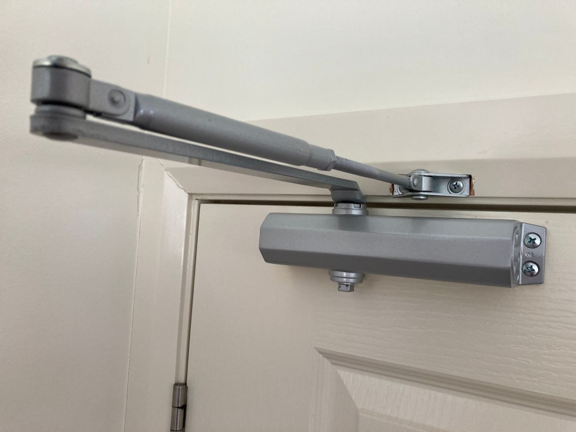

I have a Ryobi 2550 series door closer and of recent times the elbow joint of the main and forearm has begun catching on the top of the door as it passes under the closer. How can I adjust the arms to travel higher above the door.

In order for our members to get a better idea of the malfunction, would it be possible for you to post a photo of the door closer and where it is catching.
There are a few points of adjustment on the arm and where the arm is mounted itself. I suggest doing a preliminary investigation and see if any of the arm mounts have come loose. The only other thing that would cause the door return from going out of alignment is the door itself. I suggest inspecting the door hinges if they've come loose.

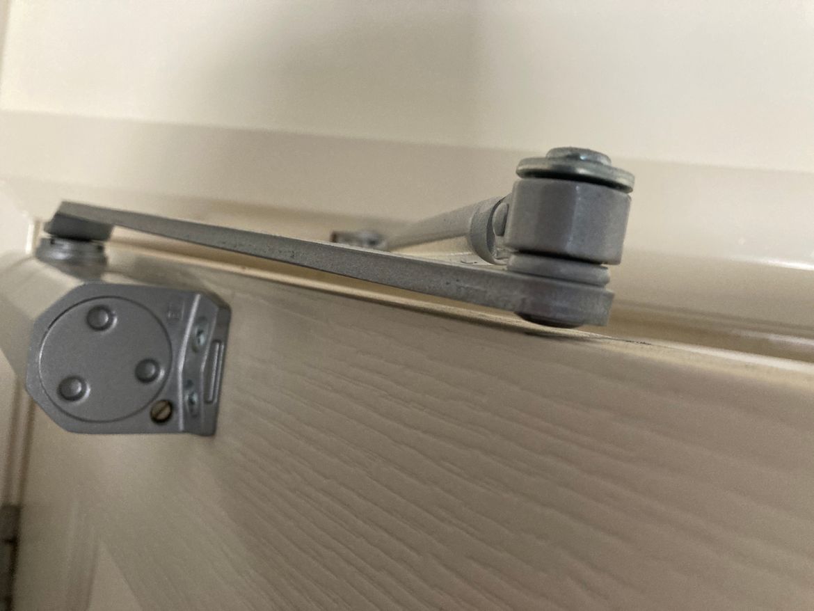

As suggested I have checked the mounting points for the closer and the door hinges and all is okay.
When the door is shut and the opener is at rest the arms can be moved vertically 15mm, but when the door is hard open there is no vetical movement at all.
In the photo that shows the elbow positioned above the door you can just see the black line left by the elbow rubbing across the door.
The arm doesn't hit the door all the time - it seems to come in patches. At the moment there is clearance and the arm is not rubbing on the door.

Thanks for the photos and additional information about your door closer. This occasional looseness tells me that there is a part of the door return that has slightly come undone. I propose doing a thorough check, grab a ladder and look at the top of the elbow and see if this a pressed fitting or an Allen key screw. If it is, try to tighten this part first.
Next, check the main pivot point near the main body of the mechanism. The holding screw might have some loose and is allowing the arm to lift causing the elbow to dip. Again, try to re-tighten this part.
If the parts I mentioned are secure, the last adjustment you can make is on the threaded arm itself. Remove the two mounting screws on the little foot mounted on the door frame and Loosen the locking nut. Turn the threaded arm once counter clockwise, once you've turned the threaded arm, screw the little foot back onto the door frame and re-tighten the locking nut.
Test the door to make sure that it still works properly.
