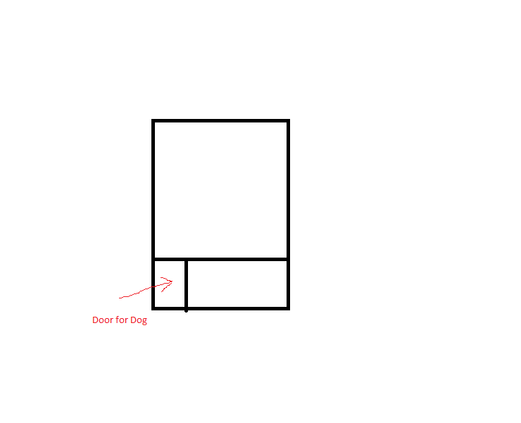

Thank you very much for your reply Pillar 2040x1000mm seems OK. But it is not enough for me. I want to put a dog door on it so I need extra 2 frame yo hold the dog door as seen in below picture

Your diagram is pretty much what needs to be done to the 2060 x 820 x 19mm Screen Door Timber 1Lite Fresco 1. You'll need to add two pieces of timber to create the frame for the doggie door. I suggest having a look at the doggie doors first and choosing the size that is suitable for your pet. Using the measurements of the pet door, you can now determine where the timber supports need to be placed.
However, before you start modifying the door, I recommend double checking all your measurements to make sure that the door will fit with your existing frame. As @MitchellMc mentioned this will take a fair bit of carpentry to build and install.
