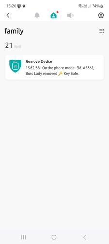

Hiya Eric
Yes, I'm going to have to call them, I removed the device as you suggested, it's not maintaining the connection.
I took a photo of how far away or close I need to be for it to connect to my phone
And it's not very far  🤔🤨🤔
