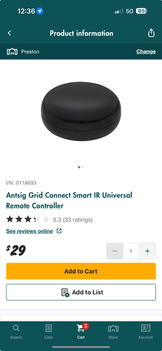

Hi Eric,
I bought antig, please find image as shown.
if you could assist as per my request earlier
that will be great help

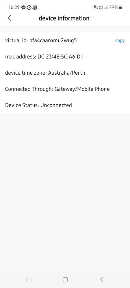

I have the keysafe DL111HA and the smart hub, and I am totally confused.
When I bought the 2 devices, my plan was to simplify my support workers and emergency personnel access into my home.
Ha bloody ha
Where is the instruction manual?  and I'm not talking about the Quick Start Guide
I have now paired the key safe and the smart hub to my phone, only to now have the key safe showing as offline.  I have restarted my router and re paired as per the site instructions, the safe is still offline

I've forwarded your query to the customer service team at Arlec via email and will follow it up tomorrow as well. The only thought that occurs to me is that perhaps the battery for the key safe is low or is too far from the smart hub and the signal is either dropping off or is having a difficult time getting through as there are too many obstructions in the way. If you wish to call ahead the Arlec customer service team number is (03)9982 5111. As soon as we get a response, we'll get back to you.
Thank you for your patience.

I have a WiFi repeater for my video doorbell which  is located towards the front of my home and I've just moved the hub right next to it.
It's still not connecting
