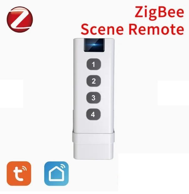

4 Gang Smart Switch Review:
I spotted this '4 gang smart' switch on Temu the other night and couldn't resist giving it a go!  (Also available from AliExpress.)
For $12.55, I figured it was worth giving it a try.  I wasn’t sure if it would work with Grid Connect, but to my amazement, it did! 😀
The only catch is that it requires a ZigBee hub. 🤔
ZigBee Hub:
I’m using a ZigBee 3.0 & BLE Mini Multi-Mode Gateway hub (Around $16.00). This hub pairs and operates with Grid Connect without any problems.
Then it’s just a matter of pairing ZigBee devices with the ZigBee hub.  (Could be worth buying a ZigBee hub to open up your 'ZigBee World'. 😎 )
Once paired, ZigBee devices then appear in the Grid Connect App, allowing full control, and any Scene / Automation can be setup as required.
Review:
The 4 gang smart switch looks and feels great and appears to be robust and made extremely well.  Functionality is exactly as advertised.
The device paired with the ZigBee hub in seconds and then it appeared in the Grid Connect App. Everything worked correctly straight out of the box!
(The black area above button 1 incorporates a blue LED which flashes during the pairing process and blinks as buttons are pressed.)
Each button has ‘single click’, ‘double click’ and ‘long press’ modes to facilitate control of up to 12 devices.
I have 3 Arlec ‘Smart Buttons’ which will now be replaced by this one device with functionality to spare!
Setting up each button in the Grid Connect App is basically the same as for the Arlec Smart Button.

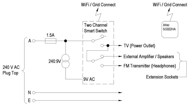

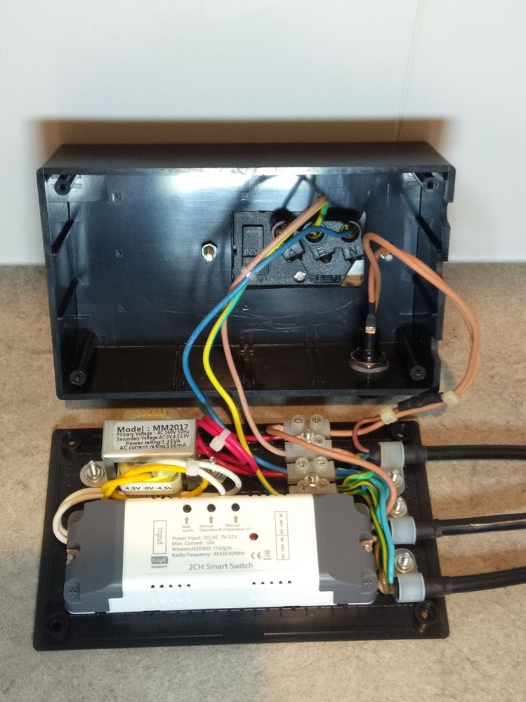

PAYS NOT TO OVERTHINK THINGS:
I thought I would share my experience constructing a little ‘two channel smart switch’ project . . .
I built this little project which I hoped would help automate the control of my (dumb) TV, external speakers and FM transmitter for my headphones. (Circuit diagram and photos below.) I was experiencing a few limitations with the Grid Connect App programming a single Arlec Smart Switch to simplify the automation of my TV and speakers etc.
I came up with the idea of using a two channel smart switch, which in theory, would enable me to switch my TV AND speakers/transmitter On/Off with one Smart Switch button and another Smart Switch button would control my speakers/transmitter.
Whilst this did work, it created a few unforeseen programming problems for other Automations. The project cost a little more than I’m prepared to admit and was obviously overly complicated for the task at hand.
Until the recent purchase of the 4 Gang Smart Switch, as per my previous post, I ended up using two separate Arlec Smart Switches to achieve the required functionality.
This did work, but it was always a problem having two Arlec smart switches on my armchair and trying to remembering which switch to use etc.
After the purchase of my new 4 Gang Smart Switch, I used the Grid Connect App to program the Smart Switch to achieve the above functionality and added a few more TV related automatons as well. (TV light On/Off, Mute, Volume Up/Down etc)
Now my little ‘two channel smart switch’ project is a solution looking for a problem and I have two spare Arlec Smart Switches in the ‘spares’ box.
Sometimes it pays NOT to overthink things!  Oh well, I had a bit of fun.
