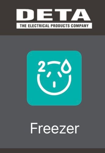

Hi all.
Sorry. Odd format for a forum so not sure if this should be a reply or a new post.
I’ve automate a number of devices at a remote club on off grid power. Very impressed so far.
Does anyone know where I can find out what changes to icons in the app mean?
Eg see freezer. What’s the change to the 2 & the raindrop mean? It’s just the simple Arlec switch block.
