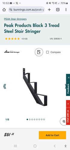

We’ve just built our new house and I’m tackling the landscaping myself. Our alfresco is raised about 600mm, and I need to build steps down to the backyard. I’m considering using the Peak 3-tread stringer, but I’m stuck on what material to use for the treads.

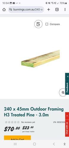

Initially, I was thinking of using 240mm x 3m treated pine, cutting it into three pieces and painting it, but I recently saw a post mentioning Ecodeck as an option.

I actually think the idea you've proposed is likely the best one to go with. It is sturdy and cost-effective and being H3-treated pine, it will be weather-resistant and durable. Adding a coat of external paint with some sand added for grit will increase their grip and extend their lifetime.

I can't say Ekodeck would be an option with your stringers. Ekodeck can be used when stepped decks are used, but this requires a considerable amount of framing. This is because the Ekodeck is not thick enough to support the weight of a person without framing beneath it. Using two stringers, Ekodeck would bow in the middle considerably.
Thank you, Jacob, for your timely reply. I will probably go with H3 treated pine and paint it.
