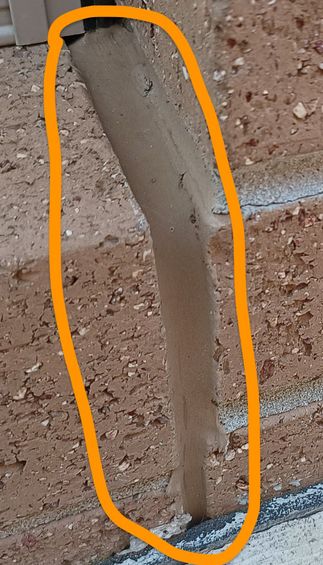

Dear Team,
Would you please tell me the name of the material used between the bricks in this picture? It is a brown colour. Is it mortar or a filler material for gaps? Is it offered by Bunnings? I need to fill in some gaps like this, so I'm simply seeing if I can purchase similar material from Bunnings. Thank you.

There are many things you can use i offer a simple easy to use product
Selleys 440g Sandstone No More Gaps Bricks And Mortar Gap Filler

Hello @CK01
Welcome to the Bunnings Workshop community. It's sensational to have you join us, and thank you for sharing your question about brick gap fillers.
I totally agree with @Jewelleryrescue's suggestion. Using Selleys 440g Sandstone No More Gaps Bricks And Mortar Gap Filler is one convenient way of filling in gaps in your brick wall. There is also the traditional Dingo 10kg Mortar Mix, you just add water to mix and once you have the right consistency, you use a trowel to insert the mortar into the gaps.
