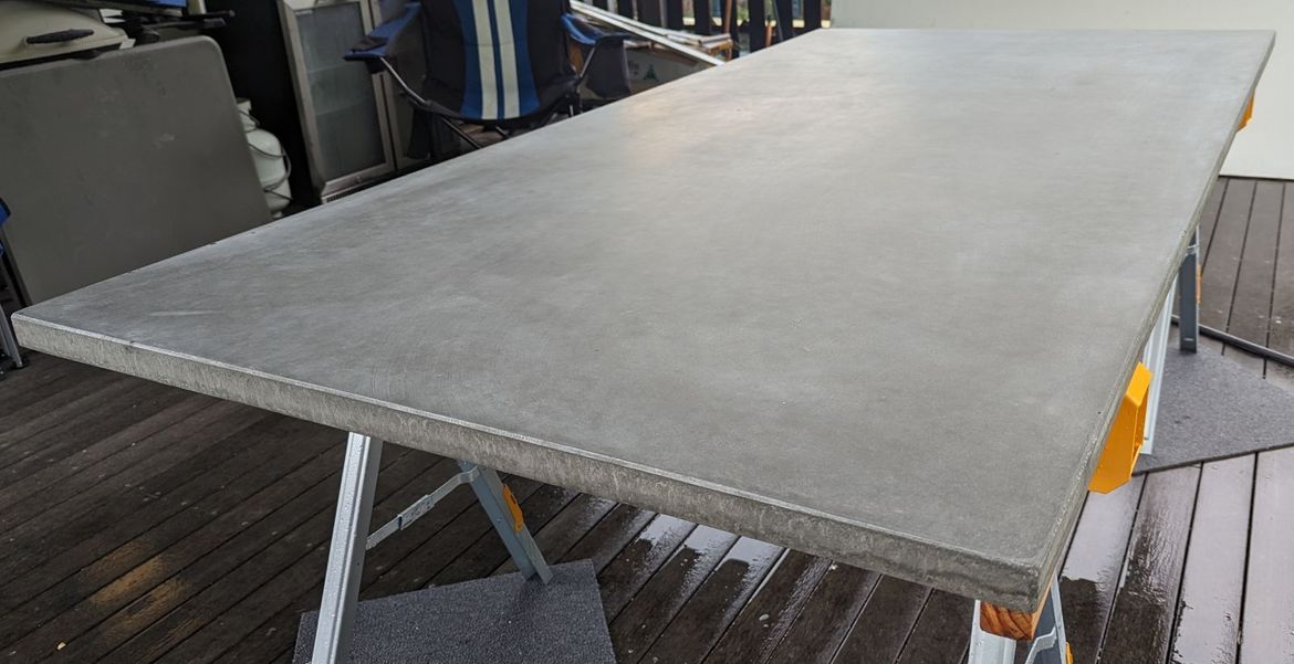

I just made a concrete tabletop using this concrete: https://www.bunnings.com.au/easy-mix-20kg-55mpa-super-strength-concrete_p0760460 really happy with how it turned out. I made it 40mm thick.
I used the 5mm reomesh https://www.bunnings.com.au/jack-1800-x-1050-x-5mm-light-duty-reo-mesh_p1060321 and made the form using melamine https://www.bunnings.com.au/2400-x-1200mm-16mm-melamine-particleboard-white-matt_p0097412

Awesome work @markw. It looks great.
I would encourage you to hit the Start a discussion button and share as much detail as you can about your project. If you've got some in-progress shots, members would love to see them too! I'm sure the community will be really inspired by what you have created.

Hello @markw
Thank you so much for sharing your concrete benchtop project. Let me tag @snowgoose62 to make them aware of your materials list. That benchtop looks absolutely amazing, is the slab free floating with no timber support underneath? What is the size of the concrete benchtop? Do you have any photos of the melamine frame before you poured concrete into it?
Any other details you can share about the benchtop creation would be very much appreciated.
