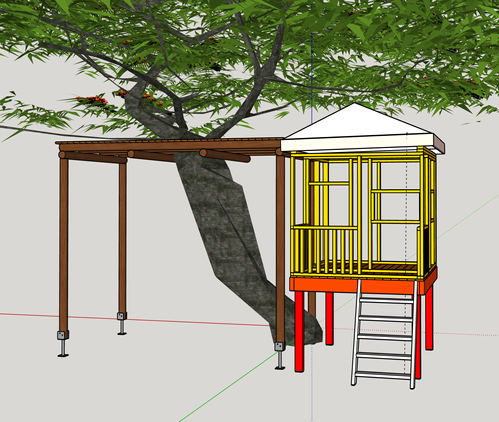

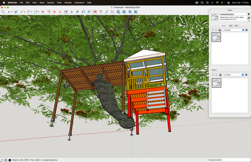

Current draft sketch - there'll have to be a good deal of 'on site configuration' to workout the cutouts etc for the real poinciana but this was a 'not wrong' sample model in Sketchup so I went with it.
This uses the 100mm diameter poles with:
- 2.4m uprights
- 3m cross beams - I've gone with 4 front to back to give about 600mm spacing for the deck
- 1.8m whatever-you'd-call-the-front-to-back-joist-type things - I've put one either side of the trunk in my model for now but in reality I think I can nestle one in the middle to put weight on the Y of the trunk which feels desirable.
Deck is currently modelled as https://www.bunnings.com.au/90-x-22mm-decking-h3-treated-pine-2-4m_p8032583
There's been a request for a spiral staircase from the cubby upwards but I may try and encourage the 'stakeholders' to simplify this aspiration 😂
@EricL @JacobZ / all - would love your inputs on:
- joints to use for the poles. I was thinking of strapping originally (a la https://www.bunnings.com.au/airco-30-x-0-8mm-x-30m-structural-galvanised-strapping_p0553627 )
- best timber to use to add some diagonal bracing for the uprights to connect to the beams and joists

Good Evening @kitfriendesq
Love the cubby house For some reason I thought Id seen this awhile back and commented. 😕
You have taken me back when I was a kid building treehouses and forts
Joints for the poles, I like notching and bolts. It has a solidness to it and feels more structually sound.
I like how the structure is seperate from the tree, trees move and its very hard to build something that covers both at the same time. The way you are going it gives the appearance of being in the treetops without hurting the tree and also without having to worry about the 5cm or more sway in the wind.
Are you going to have the ability to climb on the new horizonal section? Some sort of diagonal bracing is needed. You could always stay simple and use the same timber as you are for the decking. Its much more viewable and less likely to be run into by kids running around... or adults..
I have built a privacy screen/fort and even tho I have some diagonal bracing I should have more. If you throw yourself side to side up top you can feel it move a tiny bit.

Thanks @Dave-1 - definitely climbable on top, just haven't designed the walls or stairs yet 😁

Hi @kitfriendesq,
Building a tree house will be a wonderful experience for both you and your children to share, but we need to make sure it is done right. Considering it is going to be used by your children; it is absolutely paramount that safety is at the forefront of your design.
Understandably, it's unlikely that you'd contact an engineer for assistance designing this, but at that height, it's certainly something you should consider or at least use an engineer's mind to "overthink" and "overengineer". This is especially relevant because it will not be anchored to the tree, which would typically give a tree house a lot of its strength.
In saying this, the 100mm 1.8m Pole H4 Treated Pine Rounds are not structurally rated. These 90 x 90mm 2.4m F7 H4 Treated Pine Premium Posts which have a structural grade (F7) would be a better option. The pine rounds might be strong enough, but they are not specifically rated to support structures like this. Posts are not something you should take liberties with as ultimately; they are the main thing holding your tree house up.
As you are essentially building an elevated deck, you should apply the principles of deck building to ensure that it is constructed to a safe standard. Check out How to understand deck components and How to understand deck span tables for some guidance. You'll need bearers of a suitable calibre to span between the posts and joists capable of spanning between the bearers. You should also increase the number of joists as decking boards will usually recommend 450mm joist spacings.
The next thing to consider, as @Dave-1 has mentioned is lateral bracing. Generally, in deck building, this is something that would be determined by an engineer. I can't say for sure what they would propose, but knee braces made of the same material as your joists are likely a good option.
I think with a few tweaks to the design; this is going to be a safe, but incredibly rewarding and exciting project.
I'm excited to assist as much as I can moving forward.
Let me know what you think.
