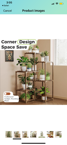

Hi all,
Which timber would I need to build something like this picture? It’s to be used outside and probably cheaper to buy instead of making but DIY allows us to customise the size to fit our space
The frame is thin so I’m not sure treated pine or hardwood dresser can be used?
Can I used hardwood like 30x12 and 32x32 DAR Tasmanian oak? Are they strong enough to support multiple plant pots like the pic? If yes do I need any specific oil or stain to use them outside?

Hi @minhletn,
You could use Tasmanian Oak, though keep in mind it’s a relatively soft hardwood and may not hold up as well outdoors compared to other options. If you go this route, you'll definitely need to treat it with a high-quality outdoor oil or water-proof varnish regularly to prevent moisture damage, as Tasmanian Oak isn’t naturally resistant to decay.
For a project like this that will hold plant pots and be exposed to the elements, treated pine or hardwood like Merbau might be better choices. They’re more durable outdoors and can handle the weight of the pots. If you’re set on using the thinner frame design, make sure to reinforce the joints well.
Here's a rendering of what it could look like using 42 x 19mm 2.7m Pre-Oiled Merbau Solid Screening.
