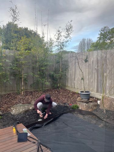

Can I get some advice. I am planning to put decorative rocks and stepping stones at the side of the area.
At the moment, we’ve pulled out all the weeds, levelled the ground and place weed mat on the area.
My question is:
1) would we need to put paving sand on the weed mat for the rocks?
2) for the stepping stones, will I need to put road base and mortar under?
Thank you!
Hi @magdaleneho17,
It sounds like you're making great progress on your project. For the decorative rocks, there's no need to add sand under them; they can be placed directly on the weed mat, as their weight will help keep the mat in place and prevent weed growth. As for the stepping stones, using a road base or mortar underneath can provide added stability, particularly if they will be frequently walked on.
However, if the stepping stones are wide and the ground beneath the weed mat is well-compacted and stable, they might remain secure without the need for additional support. That said, adding a small amount of mortar or road base can help ensure they stay level over time. Did you compact the soil before laying the weed mat, or was it already firm and stable? This could affect the long-term stability of both your rocks and stepping stones.
