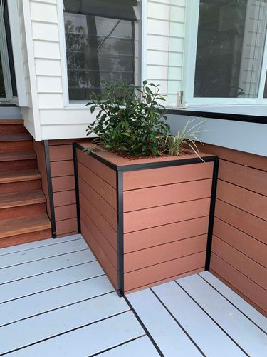

Hi @baza, I've used Ekodeck before but not perma timber. After doing a bit of research I think they are pretty much the same thing but Ekodeck might be a little cheaper (although there's no pricing on the permatimber website which is annoying!). I only used Ekodeck becaue it was just easier for me to pick it up from my local Bunnings rather than trying to find a Statco or Bowens or ordering it online

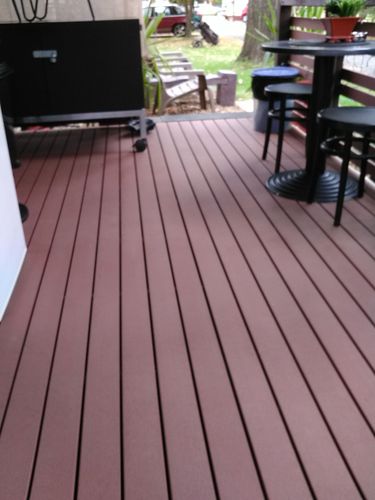

I've used the Eko products & ModWood but not Perma. In-fact hadn't heard of it until your post.
It sounds very similar to the others so may just come down to pricing, size, availability & colour.
Can they send you a sample? (I know Eko will) This would allow you to do some simple tests yourself - ease of drilling & screwing, ease of cutting & quality of cut, abrasion resistance - are a few that spring to mind.

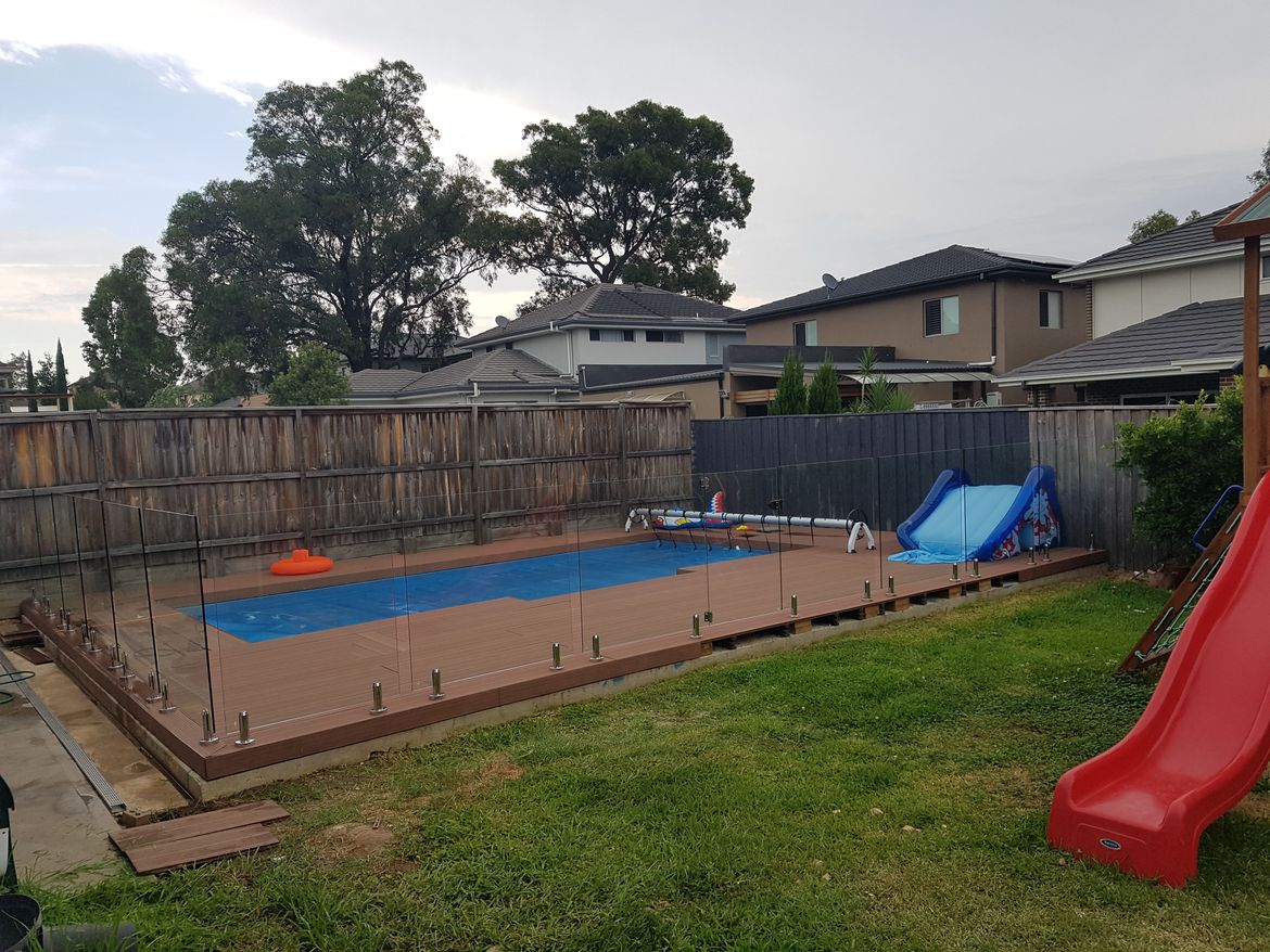

Yeh... I've tried Perma Timber before during the time when Masters was still around. (i think it used to be called Permatech). Anyways... tried the Permatimber 295 with their composite bearers + fasteners... for our pool deck. It was a challenge for me as I was building the deck alone. Each board was heavy (146 x 22 x 5400).... the bearers were also heavy.
After a couple of years... the colour started fading. I had no issues of it bowing. The one thing my kids always complain about is how hot it can get to step on on a hot sunny day.
mmmm... not much of a review. OH.... one more thing.... its really pricey.
