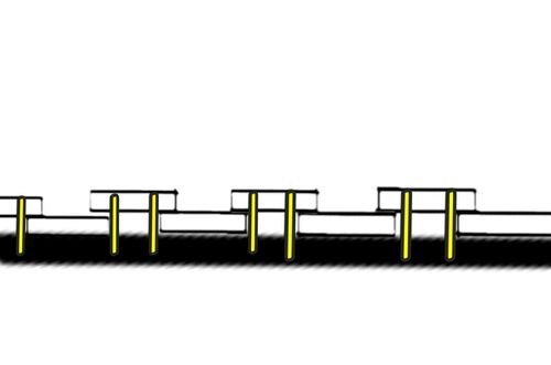

Re: Paling warping
If you use the horizontal rail idea. Try putting the nail in well away from the edge to avoid splitting. Place it so the nail goes in beside the inner palings. The pressure from the outer paling will keep it flat. Pre drill the holes and use screws for an even grip. I hope my picture makes sense.
